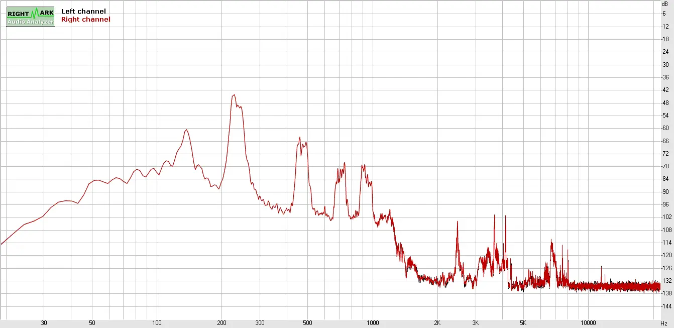

The noise must be a replay artefact, nothing on the RMA spectrum.
BTW I could not open the downloaded "wav"? Rmark said it was an unknown format. I had to open it in Samplitude Silver then export as 16bit 44.1kHz stereo.

It's much lower in pitch than VDO whine -- Even on the room noise before the Ooooo I can hear something weird going on that shouldn't be there... Sounds like a mult of some sort - probably not related to the whine, but something else that shouldn't be there.
They're on ecc83's post above -- I can't confirm 2.5k (might've been a momentary spike), but there's strong nasties at 3.7 & 4.1 and their 2x multiples.
