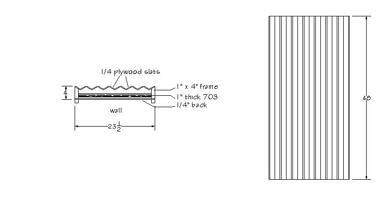

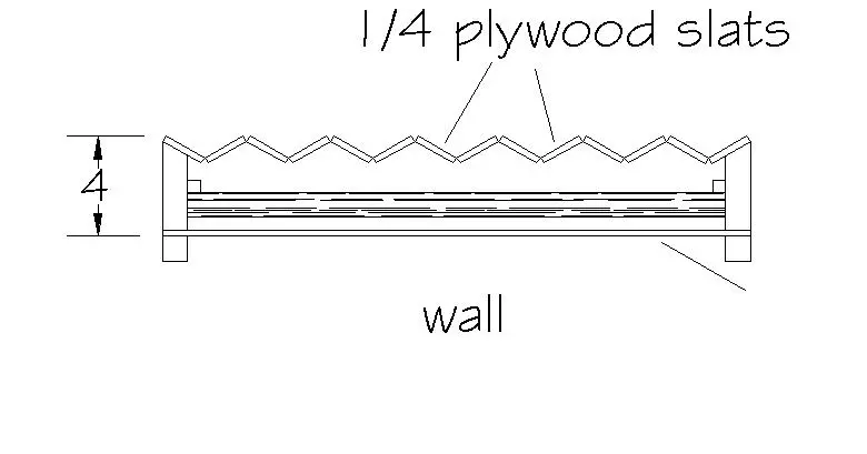

just thinking about some things here. how would this work for and absorber-diffusor-bass trap?

Just straighten out the slats and vary the slat spacing and widths and you have a helmholtz resonator.
by doing the angles, wouldnt i get some diffusion as well? i could vary the spaces and still keep them slanted. or is that defeating the purpose?
i guess, even if they are flat, i still get diffusion, correct?
You haven't really stated the purpose - things like the size of the room (all three dimensions) where you intend to put them, what you hope to accomplish, what the actual angles between the slats are, etc - for example, if the angles between the slats are exactly 90 degrees, then for anything above approximately 300 hZ, any sound that enters the device will be reflected right back parallel to the entry angle. This is true of any 90 degree angle corner. Using separate slats for the front negates most, if not all, the resonance effect that makes a panel bass trap work - slots between the slats will tend to act as a helmholz, but unless you put some kind of restriction behind the slots it won't be much.
If your room is actually big enough to benefit from diffusion instead of absorption, it would be simpler to build polycylindrical absorber/diffusors than it would to mess with all those slats and angles, and it would work better.
Maybe if you explained more of your circumstances, like room size/function/shape, and what you hope to accomplish... Steve

i am lookin at the live room. it is roughly 38 ft. x 33 ft. with 10 ft. 6 in. ceilings. i have been using auralex products for the last year and i am ready to do something a bit more professional. i have seen that detail for the cylindrical diffusor. looks interesting..
With a room that size you could definitely use a diffusive wall - one example of what it could look like can be found on Sunday TV - check out America's Funniest Videos, and the dramatic poly wall they use on that set. Larger sections work about the same, in fact full 4 x 8 sheets bowed into slotted cleats can also be used. Check out Everest's Master Handbook for a few drawings on that.
One other thing that caught my eye on your site was the nearfields laid on their side - you might try setting them upright and seeing if you notice a wider sweet spot. The only acoustic reason NOT to upright them would be if there were flush mounted mains behind them and you didn't want to screw up the imaging of the mains... Steve
you mentioned making one wall diffusive, which one would you go for? the primary use of this specific rooms is tracking drums and vocal groups. should i just pick one? most of my other tracking is done in the iso boothe..
I'd need quite a bit more info before suggesting what changes should be made - like is that drum area just a riser, if so how's it made, is the wall (the one behind the drums) that's 90 degrees to the control room window also as reflective as the window, do you use a stereo pair of overheads as part of the drum micing setup, what is the bunch of squiggly lines on the right side wall, what materials are floor and ceiling made of, but most of all what don't you like about your setup/sound as it is now?
Acoustics are tricky enough when you're in the room - long distance, they are even more difficult; so, any and all info you have about the existing setup and results would help... Steve
