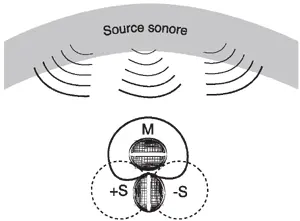

are you facing the side mic's diaphram at the source? That's what it sounds like to me you're doing. So you're capturing the source and directly behind the microphone.
The side mic needs to be pointed to the left and right of the source. Make it so the polar patterns of both mics picks up a three leaf clover shape.
Otherwise, yeah...it sounds like you got the process right
Yeah, based on your description, it sounds like you have both mics facing the source, which will not give you a good stereo image. The cardioid mic should face the source, while the null of the figure 8 will face the source. That way, the figure 8 mic is picking up the left and right fields, but not the direct sound of the source. In other words, the capsules should be at a 90 degree angle.

oops, you guys are correct - I misposted - the mic in figure 8 pattern WAS facing sideways. It was a few months ago, so I had to think about it.

You need to keep the copy phase inverted. You should have L+ and R- with the center normal.
