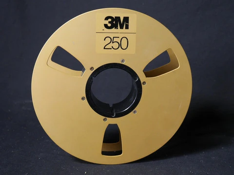

I think somewhere on this thread Beck stated Scotch 250 is sticky-prone.
:spank::eek:;)
Any ideas on 84 Scotch 3M 250? Sticky prone?
I've seen it on nearly every list of SSS tapes. Based on that I would say there's at least a 50% chance it will need baking?
Hey...just spool it up...play it for like 1-2 minutes, if that.
If it's sticky/shedding...you're not going to have to go for too long to find out.

At the very least, you've got that cool gold reel. I have a couple myself, they make great takeup reels. Six screws and thick, sturdy metal...
