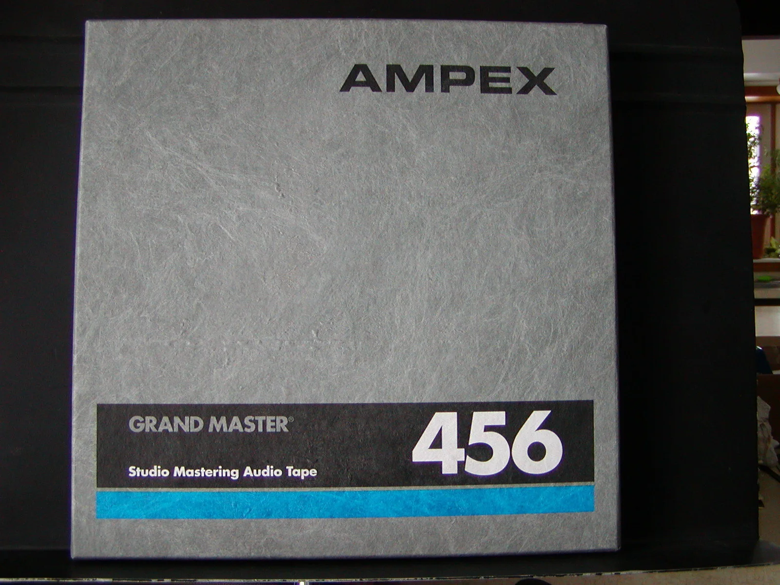

Q: Without reviewing any of the previous pages, what's the quick take on:
Ampex 456 s/n 91056, early 1991, where the Grand Master 456 logo is in the lower 1/4 of the box? It's NOS, and to me this tape looks fine, however I've not run any yet.

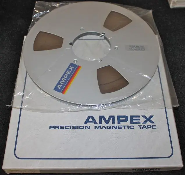

Odd... I've never seen that box style that early. Earliest I've seen it is 1994. Dave is it possible that the number is faded or somehow rubbed off and that 1 is really a 4? If it is indeed 1991 then it's unfortunately before they changed to the new binder, which was late 1994. :(
Oh... wait a minute! Is it this box style perhaps?
No,...
This:..........
Interesting! That is the first tape I've ever seen of that box style with that early of a date. I had quite a few sticky-shed reels new right out of the box that were 92, 93 and even early 94 that still had the older box style... looks a lot like that one, but the label is in the middle. Of all the reels of every different size I've seen that is a first!
I'll just have to try it and hope for the best!
:spank::eek:;)
I too, have never seen a pre '94 Ampex box in any tape width with the lettering at the bottom. Ive had a few.....
Oops!
I'd been looking thru many bins of tapes and I have several different varieties. I apparently got all the boxes confused. The tapes in question are 91056 and the label is in the "middle". I guess that solves the mystery! I will still put one or two up on the transport someday and see what it does!
:facepalm::spank::eek:;)
Yeah, I know,... I've been there, but...
the curious part of my is still dying to find out.

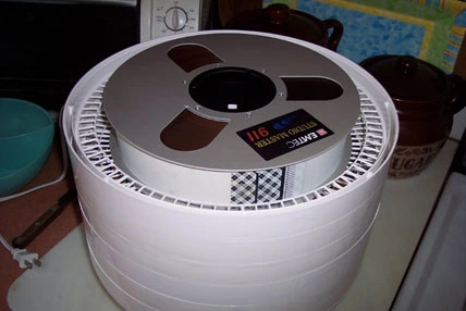

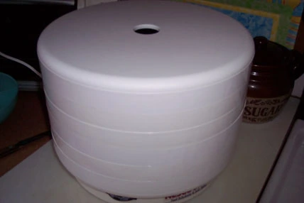

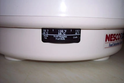

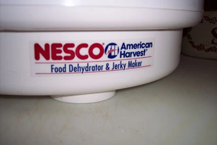

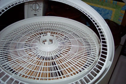

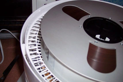

So I picked up Snackmaster FD-50 dehydrator mainly for baking tapes (and maybe for making some beef jerky too :D ).
This is an older model that they don't make anymore, but you can still find them, or a few of the newer models will work the same way. I think they just moved the heating elements/fan to the top of the new models, while the FD-50 has it on the bottom.
Anyway...this is the one I remember Eddie Ciletti recommending on his website Tangible Technology in his Analog 101 articles, so I just found the same model.
I ordered two extra tray since I new I needed to cut the rack out of them for use with 2" tape reels...and that way I had a 6-tray setup. It could accommodate three 2" reels, but I wanted to keep some room between the reels, so I just cut out two of the tray racks and that worked out well by letting me leave one empty tray below and between the two reels.
So here's a few pics that pretty much show how it all goes, and I'm currently baking a couple of reels and when they cool off back to room temp, I'll see how well the SSS has been dealt with. The first two reels I know had plenty of SSS, so they would be my test.
I decided to go for 6 hours at 135 degrees, and I was flipping them, every hour and also switching their positions top/bottom in the FD-50...that way they both got a nice even drying out.
After about an hour, once the reels come up to temp, they also help retain and maintain the temp...so by the 2nd hour, they metal is pretty hot to the touch...so careful when flipping them, especially with the heavier 2" reels.
TapeBake_01.webp TapeBake_02.webp TapeBake_03.webp TapeBake_04.webp TapeBake_05.webp TapeBake_06.webp TapeBake_07.webp TapeBake_08.webp

The Snackmaster FD-50 is great for this....and yes, the size is perfect for 10.5" reels.
If you were only baking 1/4" or 1/2" tape, you could fit one per tray....but for 1" and 2" you need to cut one tray to use as a spacer per reel.
If I had a lot of 2" tapes that needed baking, I would have picked up a couple of more tray, since you can go up to 12 trays high with one FD-50...but I only had about a 10 older 456 reels that I wanted to resurrect....though I may never use them, since I have plenty of 499 and 996 reels to last me a long time, and the deck is set up for 499/996.
Of all my 499 and 996 reels, I only had maybe a couple of each that had some mild stickiness (probably due to poor storage by previous owners -- these are used tapes)....but the rest are all good, and I must have 3-4 dozen reels stocked up at this point.
The main reason I got the FD-50 was to future-protect my tapes in case any start to go in say 5-10 years, and when there isn't too much new/used stuff to be had anymore on eBay or wherever.
It was one of those impulse purchases. I was reading some stuff online about tape decks, and once again came across the Eddie Ciletti Analog Tape 101 articles he wrote a few years back. In there was mentioned the Snackmaster FD-50.
When I went to see how much they cost and where to get one....I found out that the no longer made that model, but had other ones. I figured if the FD-50 was perfect for the job per Eddie Ciletti...I would try and fine one....and there was one on eBay, basically NIB that someone bought and never used. For $60....it was worth it.
The two spare trays were $15....so for a total of $75 I got my tape baking solution.
I already baked a bunch of tapes. Tomorrow I'm going to spin up a few and see how well the process worked for the SSS. I'll post back......
