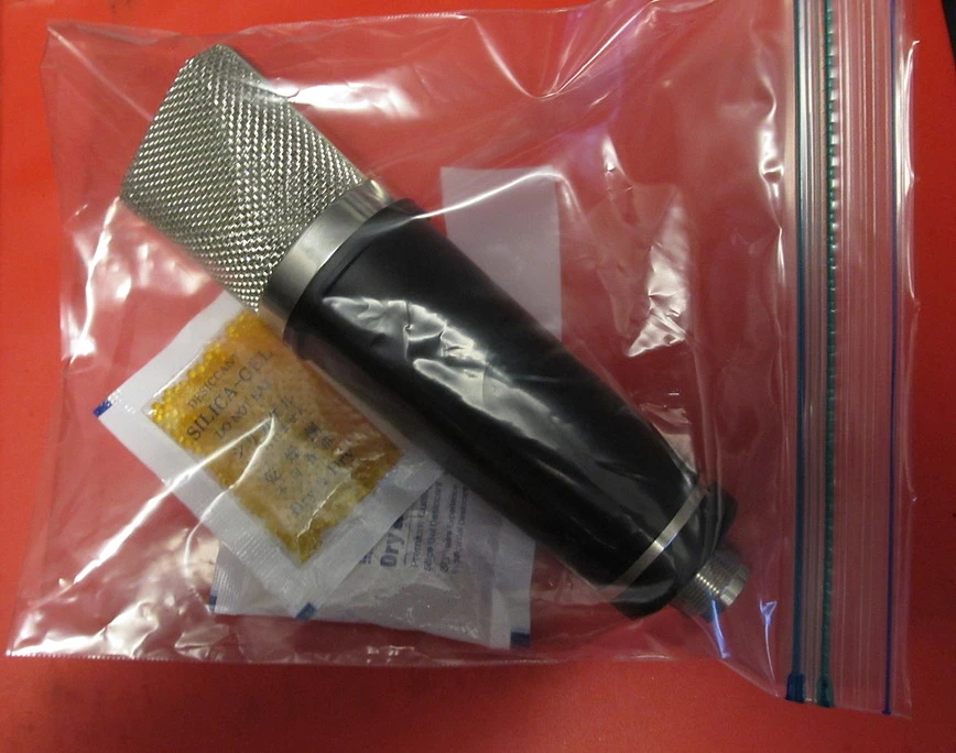

Possibly the capsule in the mic has moisture on it which may change a bit from time to time. The moisture could be there from dampness in the room air or from your breath as you use it. Using a pop filter can reduce breath moisture from getting into the mic.
Using either desiccant packs or dry white rice in a seal-able plastic bag for a day or two may dry it out if moisture is the problem. If using rice, put it in a stocking so any dust from the rice doesn't get into the mic. Image below is how I did it with a mic that had developed some noise from moisture.
It will be condensation so do this ^^^^^^
