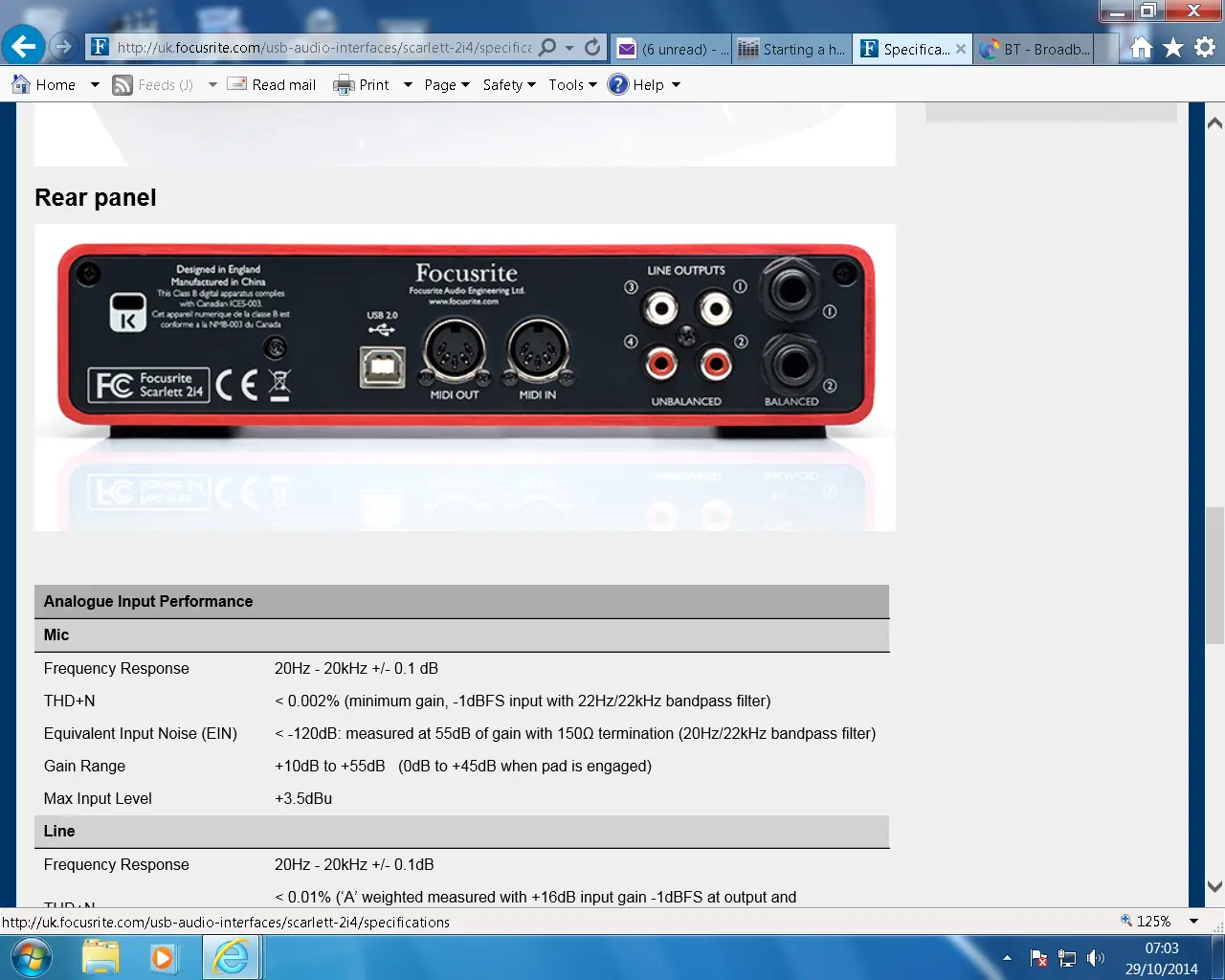

I have the 2i2 and it's great but in hindsight I wish I'd have spent the extra 30 quid and got the 2i4. There's often times when having those extra outputs would've been really useful!,
" I wish I'd have spent the extra 30 quid and got the 2i4. There's often times when having those extra outputs would've been really useful!,"
Hi Dave (great name!)
Yeah, what would have been even MORE useful is instead of duplicating 1&2 on RCA, have 3/4 inputs? Does at least have MIDI tho!
Ideally, I'd like 8 inputs and 10 balanced outs (stereo pair and 8 assignable)... Midi's good but I'm covered with the in and out on Maschine...
