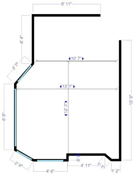

S ssman New member Jul 7, 2009 #1 Monitor placement in irregular room I've got adam a5 monitors... where should they go in this room. The blue lines are windows. the 8'11" wall is a ~5 ft? high counter opening into the kitchen, so not a solid wall. Attachments room dimensions.webp 5.8 KB · Views: 144 Last edited: Jul 7, 2009
Ethan Winer Acoustics Expert Jul 7, 2009 #2 Put the speaks at the bottom of the drawing facing up. More here: How to set up a room --Ethan
