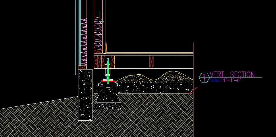

I did'nt find an answer to why the sand falling thru the joists would be a problem. Why would this be a problem?
I think this will illlustrate why. :D
fitZ

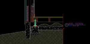

fitZ
i've read that placing the joists on pucks, which are'nt very thick, works fine for floating a floor. i have'nt tried it and really would'nt know though. that's why i did'nt see a problem with some sand falling through the joists.
