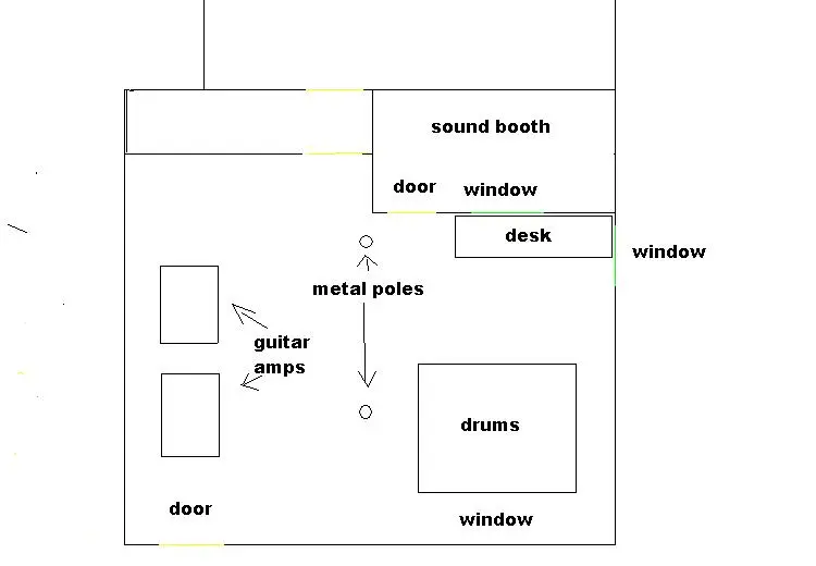

Can you do a basic drawing of a floor plan, showing where you want the door, and where the existing walls are?

If those are the INSIDE dimensions of the booth, you're already looking good acoustically - that's about the best shape a small booth can be... Steve
those are the inside demensions of the booth, the celin hight is 6' 8''. what i was gonna do is just buy studio foam and put on the walls do i need to completely do that or just in certain spots. i have any tool availiable,yes i have done carptentry work bofore, i live in tennessee.
this is a ruough drawin i did it in paint but you can get the idea

Sim, once you have a tight booth I'd only do about the top 1/3 of it in foam first, then see how it sounds. All foam will suck all the highs out of a room, same as 100% coverage of nearly ANY absorbent... Steve
