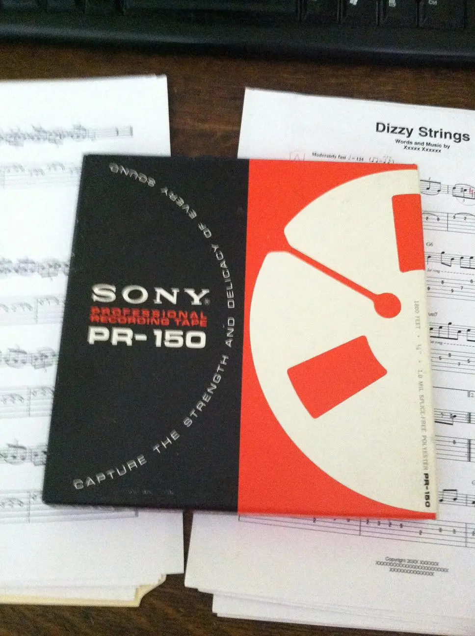

Hey y'all, I recently got 3 reels of Sony PR-150 tape from a friend for free, and I was wondering if anyone had any experience with it, how good is it, etc.
It's 1/4", 1800 ft, 1mm, which is compatible with my Fostex R8, but I can't find any info other than that.
Two of the boxes are still sealed NOS, so it would be great if it's decent tape.
Thanks!

Wouldn't know about the particular tape but if I were you I'd put in on while watching out for signs that it's sticky shed. If the machine ain't slowing down and there's no significant goo on the heads or path you should be fine with using it. If you don't wanna waste a good performance on a tape you don't know what sounds like just feed it a signal from whatever record/cd/digital file and make your own judgement on the sound.
In my experience Fostex-machines is pretty forgiving when it comes to tape types being "off" compared to the Ampex 457/BASF LPR-35 they're designing for. Of course each tape will have it's own caracter. Personally I like the sound of old AGFA tapes on my Model 80. Easier to archieve tape saturation than with the +6 tapes they're designing for.
EDIT: Ah, Beagle. It was you doing the OP, missed out on who made the OP in my high state of mind. Sorry for telling you stuff you already know.
PR-150 is ok. It's not as high energy on the level with Ampex 456, but its not sticky either. The Sony tape to avoid is SLH and ULH because they have sticky-shed.
Ok thanks for the help y'all. I'll give it a try. I also noticed that this stuff is everywhere on ebay for really cheap. Here's hoping I like it! :)
