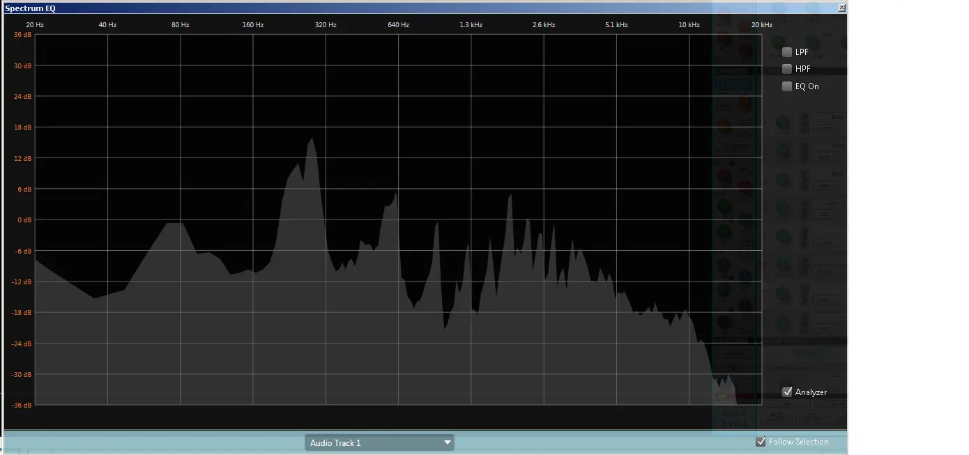

This is what I mean. The first 3 seconds of the opening vox.

As for the ~100Hz, I'll try this - I see what you mean, thanks to your screencap.
