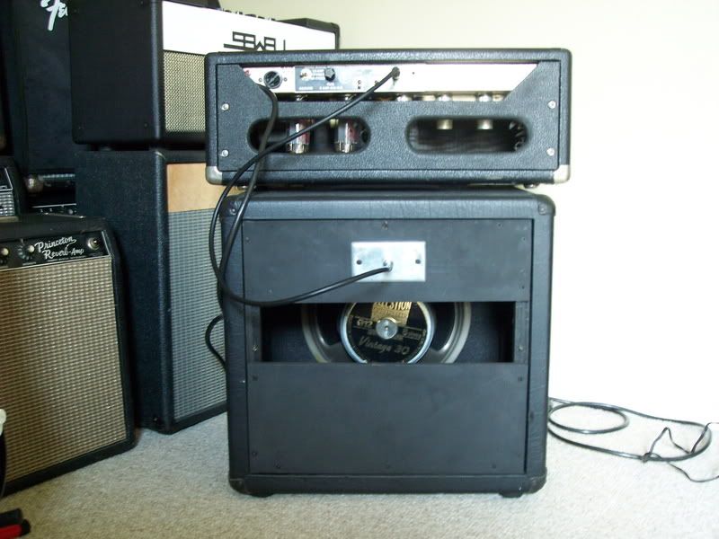

I've to a '66 Allen/Master Volume modded Bassman head that can do what you want. The Normal channel is modded to the AA-864 circuitry ala Blackface Vibrolux. The Bass channel is modded to a Tweed/Plexi circuitry. You can use a phase canceling A/B box to switch from clean to mean. Mine has been modded with the external bias points, and also to run 6L6's, EL-34's, and 6V6's. Here's some clips and some pics of the amp . The speaker is a specially made 4 ohm V-30. With the master volume on the crunch side, you can get some singing sustaining tones a bedroom levels.My local amp guru has one like this one in a Blonde head cab for $650. That's not bad for a Point to point hand wired amp with all these features.

Here's some pics of the head and the cab used in these recordings:
