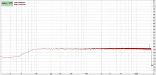

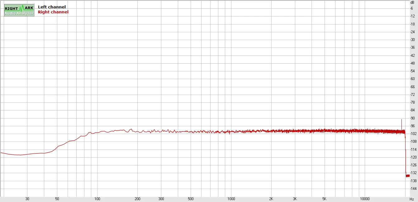

Hey Dave, would you do this for me as well. I would be very grateful as well as understanding how you can use this file to make your conclusions.
EDIT: Hey Dave, I still have no idea how you come to your conclusions, but you got me to thinking. Believe it or not, that don't happen often. So this is what I did. I followed your advice with about 8 secs at no gain, 8 sec with full gain and the mains out control set to 00, then 8 sec with all the gains wide open. I rendered the file as you suggested and then placed the freq analyzer on that track. The first two recordings showed no change but the last recording with all the gains wide open, showed around a +30db boost. The noise floor for the first two was around a -86dbs and the last jumped to around a -56dbs. Am I close or way off base? If nothing else, it does show the Alesis with 30dbs of gain. Anyway, here is the file if you have time.
Morning Mack, always glad to get peeps thinking!
I am actually not sure what you want me to do? Silent recording yes, but with which AI and on what DAW?
My post about a silent recording was actually aimed at the OP in order to establish a noise floor for his system.
Anyhoos, YOUR clip...
Starts at -71dBFS peak*/ -82.6 rms then jumps to -47.6 peak -70.0 rms. Not in the Prism range by any means but decent enough I would say for a singer right onto a 58. This was the Alesis what?
The Right Mark anny shows a total lack of 'spikes' VERY commendable for a USB device. I cannot explain the low end roll off, a consequence of MP3 to .wav conversion? (R Mark can only handle 16 bit .wav. HR attachments can't!)

@ecc83 . Thanks Dave. It was the Alesis Multimix 8 USB FX. I also have the Alesis Multimix 4 USB FX and it reads just the same. The reason for the low end roll off was I had the "Lo Cut" button engaged. The pic below shows doing the same process with the lo cut off.
EDIT
: I also should have mentioned that if I use it for the sm57, 58 or the atr 2100, the main gain control is set at 12 o'clock, then fader gain control is around the 10 o'clock and the master out control is set at around the 1 o'clock position. This will but my input signal between the -12 and -18dbs range.
I do not think it would run a mic like the Shure SM7B though. If I remember correctly they need something like a min of 60dbs of gain.
[MENTION=89697]ecc83[/MENTION]. Thanks Dave. It was the Alesis Multimix 8 USB FX. I also have the Alesis Multimix 4 USB FX and it reads just the same. The reason for the low end roll off was I had the "Lo Cut" button engaged. The pic below shows doing the same process with the lo cut off.

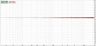

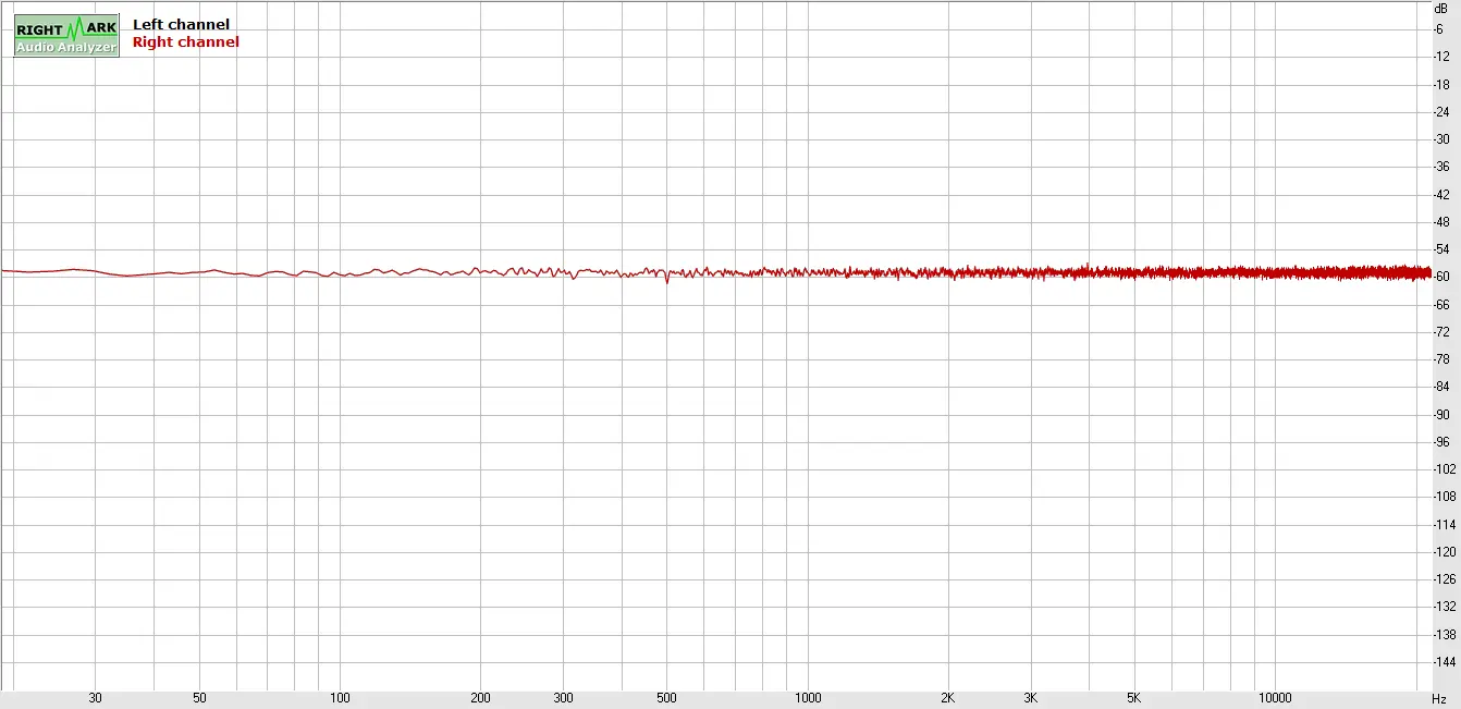

Gotcha!
It has occurred to this old brain that I have been chucking out spectra here with no reference and that some peeps might think I have a $10,000 super system! Not so, the best noise floor is given by the KA6 at min gain and is about -103 dBFS. My 2496 in a desktop just beats -98dBFS but with a 50Hz 6dB blip that defies detection. No matter, those noise floors are more than good enough for any real world music work (and of course would be worsened for 16bit CD)
Attached is a plot of white noise at precisely -18dBFS peak in Samplitude and it shows that RMAnalyser 'improves' the noise floor by some 42dB!
I guess there IS a way to calibrate it but in truth I just use it for spotting hums and other nasties, mostly in forumite's clips since I have no musician here any more.

Very good to know Dave. THANKS for the OJT.
