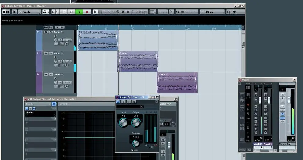

Ok man. I think this is kinda what you are trying to do. Yes this is Cubase 6, but I dont have LE installed anymore. I don't remember if LE has a limiter or not. A compressor could be used as well.
