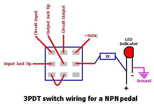

No, that's not true bypass. The input of the circuit is always conected to the guitars signal, which means it is always loading the pickups. This goes by the delightful nickname of "Tone sucking," because that is exactly what it does. If you want an LED and true bypass, it looks like the attachment.
