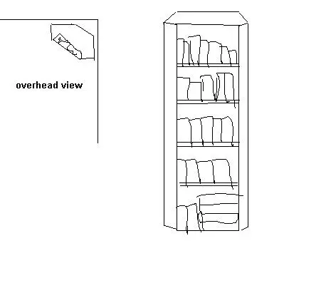

Simple question really, I have this spare bookshelf that is designed to fit in a corner. I am just wondering if it would have a bad, good, or neutral effect on room acoustics if I put it in the corner of my studio space?
It would have books and other things on it. It is tall, running all the way from floor to ceiling and is on the opposite side of the room from where I have my "control space" set up (I currently only have a single room I can use, roughly 30 feet by 15 feet, by 8 feet tall. My "control desk" is 12 feet away from one wall, pointing back to the wall so that there is a 18 by 15 space in front of me, and I can hang packing blankets in front of the control desk to sort of isolate the recording area from the control area (mostly to prevent feedback with the nearfield monitors when I run the condensors really hot).

> I have this spare bookshelf that is designed to fit in a corner. <
I think it's a bad idea because it gets in the way of installing acoustic treatment in that corner. All rooms need low frequency absorption, and the best place to put that is in the corners. Is there any way you can put the bookshelf against a wall out of the corner?

Re: bookshelf. The only reason I am considering this is that there literally is nowhere else in teh house to put it. I will just have to see for myself if it is good or bad or makes no difference.

I defintly agree with Ethan here, No way would I sacrifice valuable corner space for shelving, Traps man,,, traps... It will be bad, and it does make a difference.
To directly answer your question in terms of what will it do- books, especially big heavy ones with their varying sizes and thicknesses add a good measure of absorption and a dollop of diffusion as well. This, I guess, fits into the "makeshift" category of acoustic treatment. I've been in a library room about your size with a 12' metal ceiling that had lined the walls with books, and it was as dead as a doornail. ( mind you, I don't know what there is particularly dead about a doornail.. )
I'm not saying it's the best thing to do with the corners, but clearly you're not putting it there for treatment purposes so my estimate is that it will not adversely affect the current sound of your 30' room. In fact depending on how the rest of the room is outfitted, some added absorption and diffusion may not be a bad thing.
Bottom line: it's not permanent. Try it and see, report back.
I was looking at John Sayers website and the directions for how to build a bass trap, and bizarre as it may seem, that dang near describes the bookshelf! It is designed to fit into a corner, traps a space of air behind it about 10-inches deep in a triangle, runs almost flush to the ceiling,m and behind the books is another "dead space".
