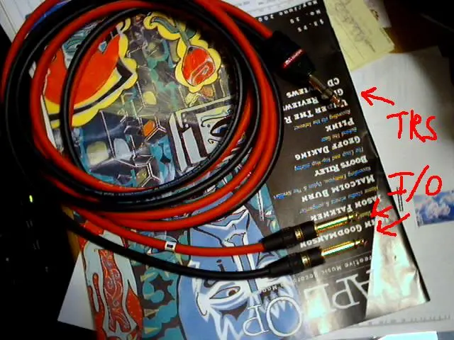

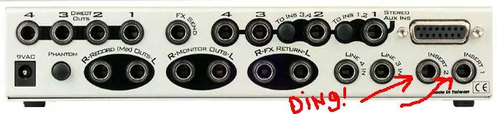

Wait...so the left input on the compressor in the diagram is also an output back to the insert jack?
Yup! That's the perk of the whole TRS cable/jack set up; you can have just one cable take the place of two... Note the little tiny print under the Left input that says "Tip=In, Ring=Out".
Go here to get a better detailed image of the back of the RNC:
