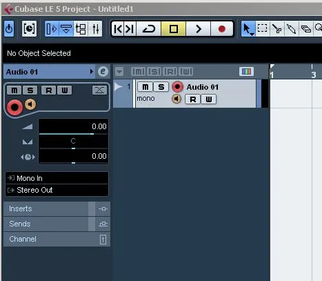

Create a mono track for mono sources. You have stereo a stereo track that is looking for 2 inputs. Project>Add Track>Audio...>check that 'Configuration' button and select 'Mono'.
Instrument tracks do not have anything to do with the Lexicon as far as input goes. The 'Mono/Stereo' button on the Lexicon does nothing to change the input to Cubase. Only for monitoring direct sound into the unit.
Then select another source. If your mic is plugged into channel 2 and you have channel 1 selected, it will record nothing.
And wouldn't you know, I did that yesterday. :facepalm: Recording a school band with 4 mics. I was in a rush to set up and forgot to set channel assignments. All 4 tracks recorded from one mic. :(
{Edit} Just saw it was a Lexicon Alpha. But still, check your channel assignments to be sure you have the correct source selected. I'm talking about in the "Inspector" part of the timeline, not VST Connections.
This^^^.
You likely need to change the input to Mono In 2. :)
