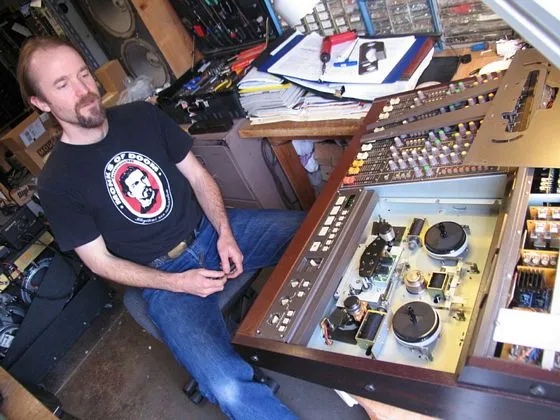

Hey, I thought I'd repost shedshrine's pict here properly for all of eternity. ;) The 388 on the Surgeon's table. :(
When I first called him about the symptoms I was experiencing, he said it could just need adjustment or it could be a motor. I ordered a motor just in case he needed it, as I can return it within 30 days.
Well, He said this was definitely a low use machine. The smoke was not an issue with the mechanical problem, (and after a week of baking soda the smell had dissapated to minimally noticeable) He set about adjusting the servos for the transport and found that the current was not stably getting from point a to point b and started swapping chips from the feed reel circuit to the take up circuit to check for bad ones (with this really trick de-soldering gun with high quick heat burst), which allowed him to determine "the microprocessor chip" (though he hadn't entirely ruled out the motor yet).
Other things he mentioned or that I witnessed: He has his own 2" otari, and Ampex decks at home, he said drums recorded hot with no dbx on the 388 would be good :D , he reccommended a guitar tech who is "the bomb" with setups, he had deoxit, he had tentelo meters, he explained why Neve is so covetted and hard to imitate, he explained why it is difficult to mod or upgrade the 388 circuits as they are designed to specific specs...

Picked it up yesterday. The smoke/humidity had more effect than previously thought, specifically the transport adjustment servo pots directly under the grate opening on the top deck of the unit. They are little carbon trace dealies, so any corrosion will mess up their travel, making fine adjustment impossible. He's swapped them all out for new ones, and got the desired adjustment response. Fast forward and play work fine now. Rewind still has minor occasional jumpiness, but works fine,and does not affect function. Record and playback on all channels is okay. The motors don't seem to be an issue at this point.
So, now, finally, good to go.
