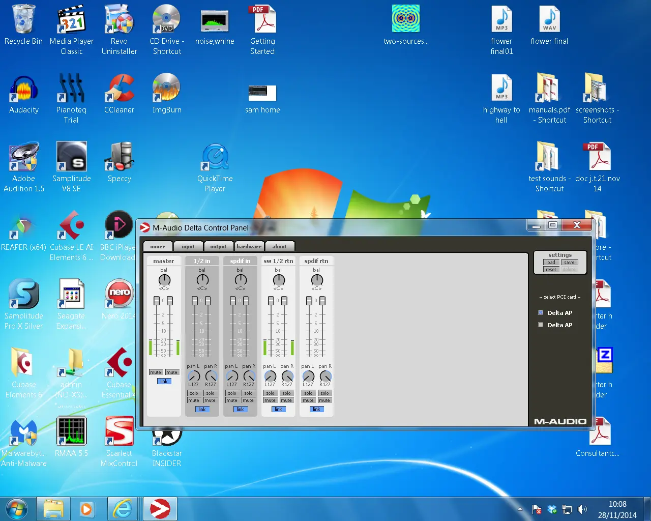

Hi, thanks for your reply!
And yeah, I have the M-Audio control panel installed. But I can't manage to get it to work with the mixer.

Are you sure you have identified the inputs and outputs on the 2496 correctly? Not easy to see when installed, check manual.
Find a radio programme or youTube track and play it. Do you get the green bars running in the mixer as per the attachment? If not check in Device Manager that the card is installed and enabled (no yellow "!") . If it isn't that is a side issue we must deal with. We shall assume all is tickerty boo! If you still do not get the meters running (all faders to max as shown) you will need to go into the Windows Sound Menus and set the card as Default, then check "levels" push to 100%. Ok! Got greenness? Now plug the 2496 RCA out into the mixer RCA tape/cd inputs. Plug in headphones and you should get sound. Ok? Nearly 1/2 way there! Try various positions of the two monitor buttons.
Keep the cans on and plug in guitar to line input One. (yes, not optimum but will work) Leave channel fader at "0" and gain about 1/2 way and dick about with the monitoring buttons again. At some point you should get the guitar. Assuming this is so, connect Tape out to 2496 line in, the guitar should blip the 2496 meters. The beauty of this "card/mixer" method is that you do not have the confusion of a DAW, setting tracks etc. The soundcard will accept and repro signals all on its tod.
So try all of this and if you are stuck at any point come back and I will deal with specific issues. Getting the system setup for the first time can be daunting but once done it will be FAR more stable than most AIs (save the KA6 of course!) and, despite its age, the 2496 still delivers excellent sound quality and lower latency than almost any other sub$500 AI (save the Ka6 OF COURSE!) .

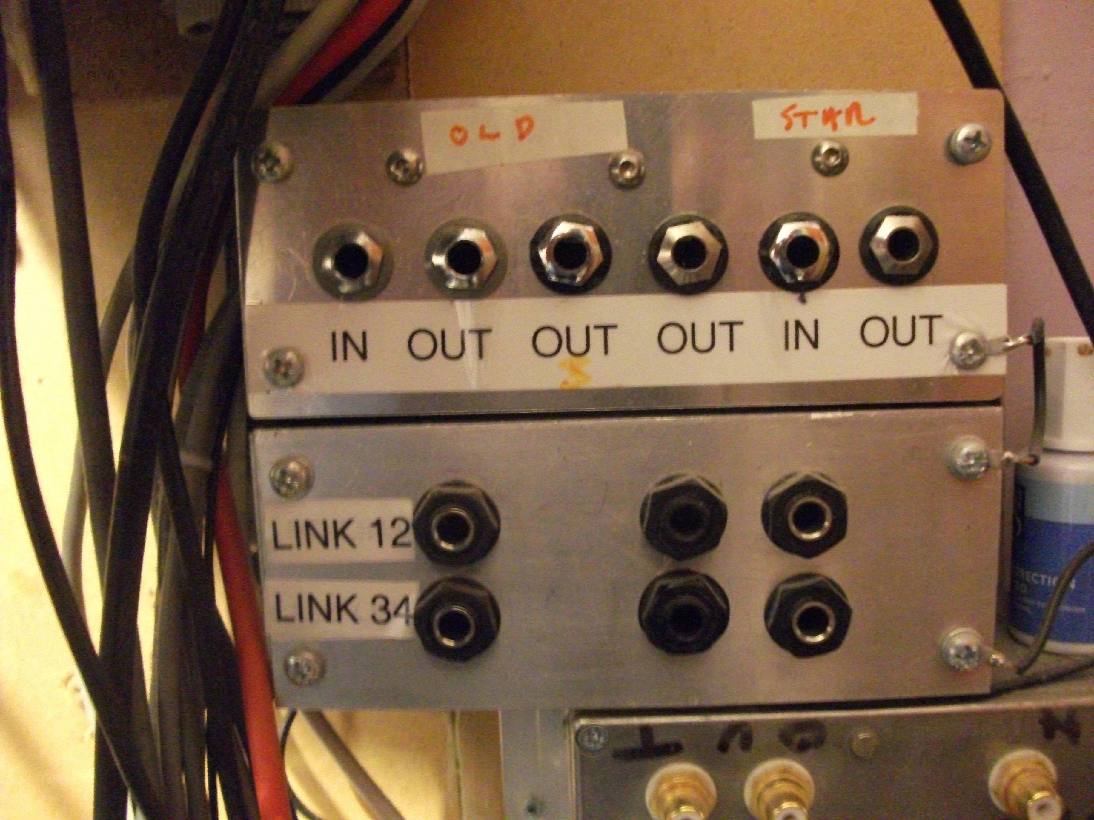

"When I had the 2496 in my PC I had a set of RCA cables semi-permanently connected which I labeled IN and OUT with a couple of paper string tags so I could easily tell what was what rather than crawl behind the PC. Easy to screw up what you think is in an out without a close look at the card."
Hah! I have the conns' Dymo'ed to the back of each computer! Then, I got SO fed up fishing about for wires that I built the "breakout" box* shown in the hastily grabbed photo attached.
You ask, new friend, "Why soldering and such?" Because even if you do go the "easy" route in this recording game you will always, eventually run up against a problem that needs a special cable or! The XLR plug will drop off the mic lead at 2 am on a Sunday morning.
The box in the photo is simply 6 TRS jacks wired down to RCA plugs for the cards. Marked "Old and "Star" because those are the names of the computers they routed to. Changed a bit now but I know the system so well now I don't need the labels.
The boxes are beer into water to make. Just drilling and soldering and the ability to follow a simple diagram.
*I am a bit obsessive! Got b.o. boxes for MIDI and S/PDIF.
