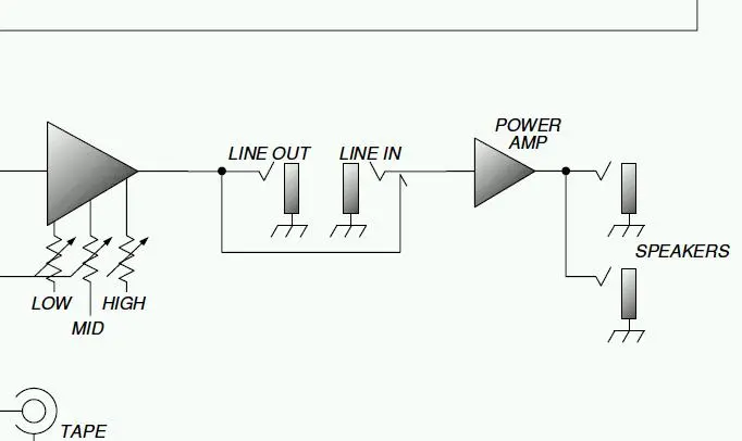

(edit) The attached image is an excerpt from the PA6FX block diagram. It shows that the speaker outputs are powered from one amplifier channel.

oh...i didn't know that i thought the pa6fax was stereo. I guess i figured two outputs would just be L and R. Just a standard speaker gauge cable.
it would be stereo if you went out of the "mixer L + R out" into another 2 channel power amp. the amp on your P mixer is only one channel. all that is neccessary for live shows...
