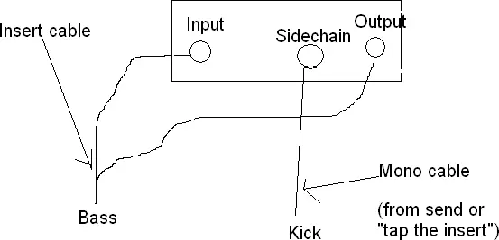

I really don't want to hijack the thread, but since this is somewhat already a subject, and could be helpful to bunt, what is "sidechaining" ? I've been wondering that for quite sometime.

When signal goes into a dynamics processor it is split into two; one that is altered by the processing and sent to the output, and one that goes to the detector circuit to trigger the processing.
Side chain processing is when you alter the signal going to the detector circuit of a dynamics processor. If you want the dynamics to react more or less to different frequencies in the signal you can filter (eq) just the detected signal using the side chain. De-essing is done like this, where the offending frequency range of sibilants is boosted in the side chain of a compressor so it reacts more strongly to them. The output is not filtered, but the gain is reduced when sibilants are present.
You can also use the side chain for ducking. With background music routed normally through the compressor, feed another signal, like an announcer's voice, into the side chain. When the announcer speaks the compressor lowers the music, then turns it back up when the announcer stops speaking.
The most basic explanation for sidechaining is something like "using one signal to process another signal". You can either send the signal out to *something* and back in using a sidechain cable (like to EQ the signal that's processed without actually EQing the final result) or you can just use the output of a different signal altogether.
edit: Bouldersoundguy explained that better than I did, lol
When I used to do live sound I would sidechain the kick drum through the compressor on the bass channel so that everytime the kick drum was struck, the bass would sort of "duck" out. It made balancing kick and bass very easy, sort of automatic, even, for live purposes. I drew a little picture and I'm gonna try to attach it here... crossing my fingers :D

Right on, bro. Thank you! That makes perfect sense. So, basically (just to make sure I'm understanding it), and example explanation of side-chaining would be putting an effect through the "side-chain" so it would go through the side-chain, directly to the trigger point of a DSP, causing the DSP to be triggered by that feed, instead of the signal the DSP is processing.
Dang, that's so friggin' conceptual... almost made my brain explode. I hope ya followed it. Anyway.. Thanks for the examples (and the diagram, TyphoidHippo). I believe I understand what it is now.
You got it. Another way to think of it is like.. Splitting signal A into signals B and C, then sending B to the input of a compressor, C to the input of an EQ, and sending the output of the EQ to the sidechain insert of the compressor, would be exactly the same thing as just sending the signal out and back in through the insert jack, just messier. The point is the signal that is sent *in* to the sidechain insert completely replaces the original signal as far as what the compressor is going to *react* to, while the original signal is then acted on by the compressor.
If the compressor had two inputs, one for "signal to act on" and one for "signal to react to", that would be basically the same thing, with the important difference that by making the "signal to react to" input an insert-point (inline with a split-off copy of the "signal to act on", which is what a sidechain insert is), you're saved the hassle of splitting that signal yourself. It's a pretty elegant design, in my opinion.
