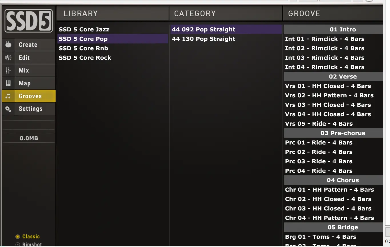

I have Windows 10 (which I prefer and a pre-7 version of Reaper, which I also prefer). I have just downloaded drum app SSD5. When I open it, the bottom of the screen for the app is missing. Reducing the size of the window for the SSD5 app does not help. Is it possible to get the full app window on my screen without reducing everything else on the screen (i.e. I hope not to affect any other programs). Screen shot shown. I cannot get to the icons below the word Classic or Rimshot (on LH side, bottom). Your help would be very much appreciated. Thanks, Brian

I have solved the problem. In my Windows 10, "Display" was set at 150%. I changed this to 125%. Now, everything is fine. Brian
