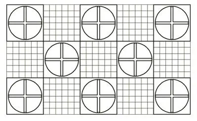

Actually, I believe they are designed for use in an array. Like this..50% diffusion-50% absorption

Rick is right on. Poly's (or variants like this) have advantages and disadvantages over other type of diffusion. On the plus side, there's really no minimum distance rule. Also, polys don't have the upper limit from a frequency standpoint that other types of diffusers do. On the down side, you don't want to put a bunch of them right next to each other. The result would be very nasty, very pronounced polar lobing. They're really better suited for use in an array like Rick suggested. That produces a well-behaved, well diffused field.
I think those semi-cylindrical polys would work well.
Diffusion for more than 1 octave? Kidding aside- Wouldn't they diffuse more in the higher register and not much in the lower mids due to size? i.e. how low can they get. No testing on the site other than a diagram of the 120degree dispersion angles. Would that be 2D?
I did notice the recommended array use-which makes sense due to lobing.
