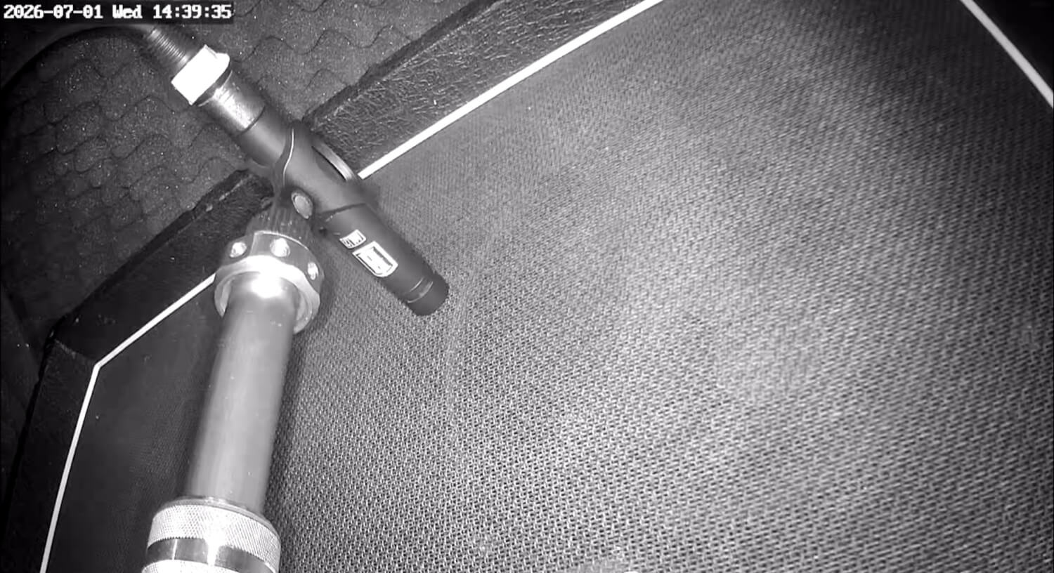

As shown in the video the solution works perfectly. However there is no step by step in the neewer app.
The small steps work perfectly with the box open by quickly clicking on the move button. However with the box closed it's too unstable. If they would add a step option it would be a perfect budget solution.

So it moves the Mic horizontally - what do you mean works with the box open but not closed? BTW IMO micro-movements don’t differentiate the sound much - plus in the days of engineers we used to do the same thing with the 2nd Engineer who would move the mic around - honestly it didn’t do that much - as you get out from the cone center the sound got less treblely - which was sometimes useful - like when stack guitars.

The cab is inside a hushbox. With the box open the remote control works perfectly with the box closed it's missing some input which makes it too unstable to work nicely.
That's very cool, but 1) the guitar in the video should 100% be being tracked live (reamped, I suppose) in this video so you can hear the sweep of the mic as it moves, and 2) I like to use a very bright flashlight up against the grill too, to help see the speaker underneight - you'd have to have very tight back-and-forth tolerances, but placing a small flashlight on a separate boom could work.

Flashlight works like a charm .
I'm normally starting on the dustcab edge but slighty towards the cone. But love to blend tones. So that's why I started the experiment ;) this cab has a wonderful warm tone.

well done video, watched it twice then saw the "trolley" at the bottom on wheels moving.! ....pretty clever and remote controlled. never seen anything like that.
I suppose to note the sweet-position- you could attach some type of ruler on the grill to note the exact position then open the box and place the mics there for recall?

The idea was to use the dolly to experiment and use a slider with markings as soon as I found the best positions. It's mostly also just having some fun.

You can get a dolly with android support for 75-100. This one was 135.
We also will use it for video so it has an end purpose ;)
