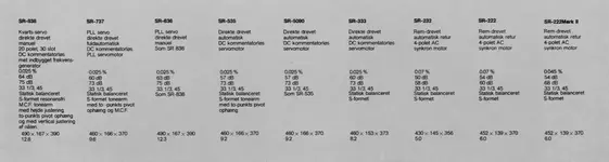

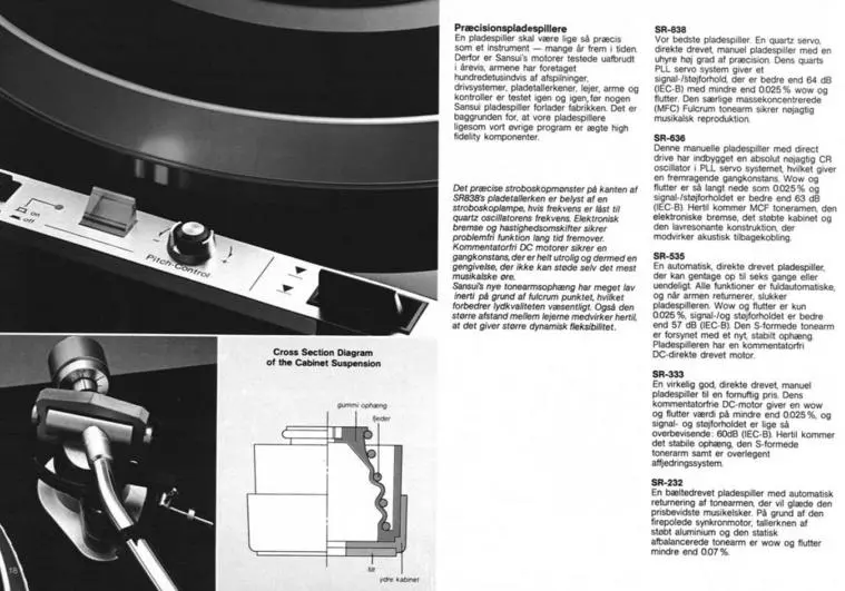

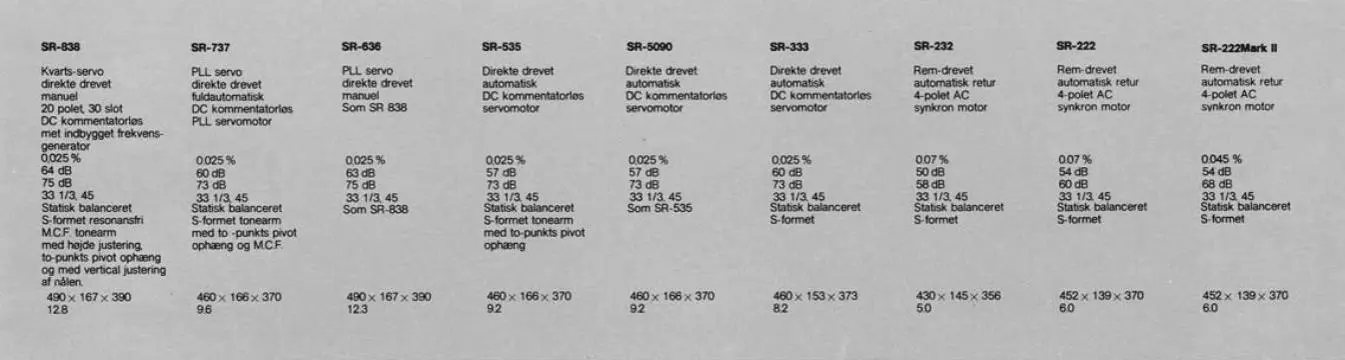

Well, I found a German 78-79 full line Sansui Catalog with the SR-535 in it and so now I know some of the specs.
It is 21lbs.
Its got really big feet on the bottom.
DC servo direct drive..."kommentatorles"...brushless?
Not top-of-the-line by any means but it looks like they had 9 models during those years and the SR-535 is #4 from the top-of-the-line.
Didn't make a note of the stylus mount type.

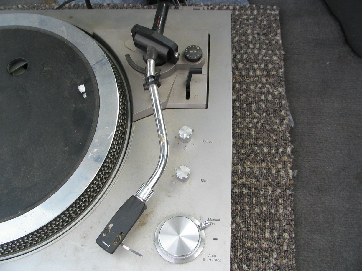

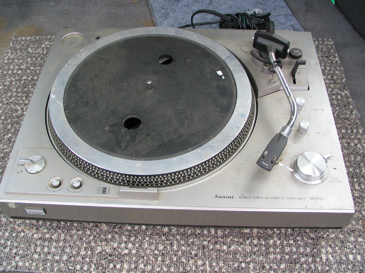

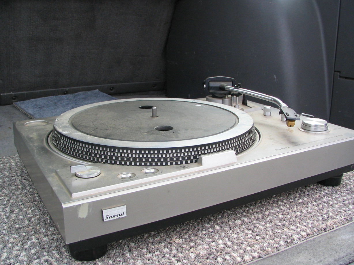

So here it is...
  • No dust cover (not a big deal)
  • No platter mat (where to get one?)
  • As soon as I plug it in the platter starts spinning and never stops. The speed adjustment works but "manual" or "automatic" settings don't seem to make any difference...it spins all the time whether or not the stylus arm is parked. :confused:
  • Autmotic mode doesn't do anything. I can hear stuff clicking around in there but the arm doesn't move.

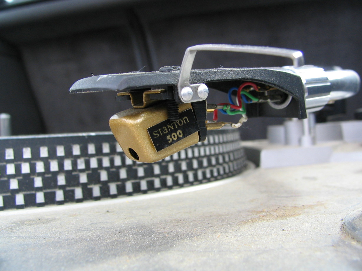

  • Stanton 500 stylus...good? Bad? So-so?
  • Needs cleaning up, but its not bad.
  • Big soft feet on nice springs.
  • Pretty hefty unit.

I assume you mean a Stanton 500 cartridge, because judging by your pics, you don't appear to have a stylus. I tried to find some info on your cartridge here, but it didn't show up. I don't know much about Stanton, except that they are still around (evidently really big with the DJ crowd), and they still make turntables, etc. Looks like they make platter mats too. I know I've seen platter mats in some record stores, and I believe some bands sell customized mats with their band logos on them. Just look around, I'm sure you'll find something.
That's just my ignorance...I don't know what the difference is...so the cartridge holds the stylus? I always thought they were one unit...:confused:
And I won't pay any money on it other than to get a platter mat and a, uh...needle...It turns and I don't care if it repeats or engages automatically...if it turns and holds a reliable speed and sound comes out (once there is a needle) nothing else really matters.
Nope, they're two parts. You can buy them together or separate. I'm not exactly sure of the current going rates, but the pro audio shop just off Ohio State campus was selling styli for $50-60 and a cartridge/stylus package for $80-90.

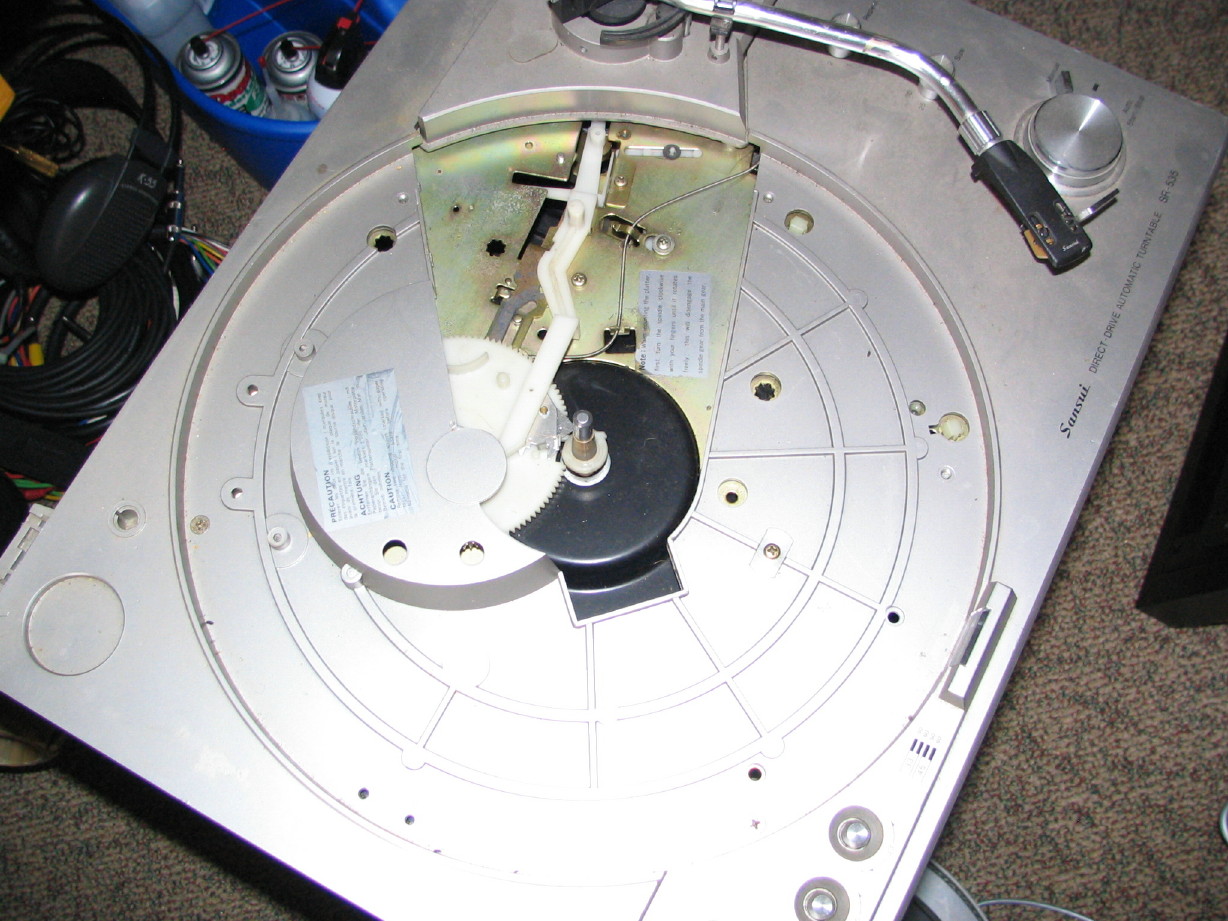

Sorry for the poor quality pic, but that stuff still back in Ohio, so it's not like I can take another shot...
Cory, I'm with Audiophallic ... I wouldn't put any money into the Sansui. You can get a better, complete, fully working turntable for less than it would take you to buy all the parts the SR needs plus it doesn't guarantee that you'll get it working. That plus the time and stress must account for something, right? There are tons of good turntables on craigslist daily. I've been looking and researching for quite a while now and know what to at least look for. You're in Oregon, correct? What's your "pickup" radius, where you can easily and fairly quickly drive out to take a look at turntables? I'll keep an eye out.
Open it up and you will likely find a small belt that operates the arm via a couple of microswitches. Belts are available. A good stylus can be over a $100buckeroos.

Stanton makes all range of cartridge and stylii. Id steer clear of the DJ ones, they are ruggedized for that abuse and they are harder on your vinyl. I run a 681EEE in the table in the studio.
Look on eBay for platter mats. Im sure something on there could be made to work.
A new stylus wont kill you:
Stanton 500 Cartridge Stylus D5107 D50 500EL 820 D7AL | eBay
