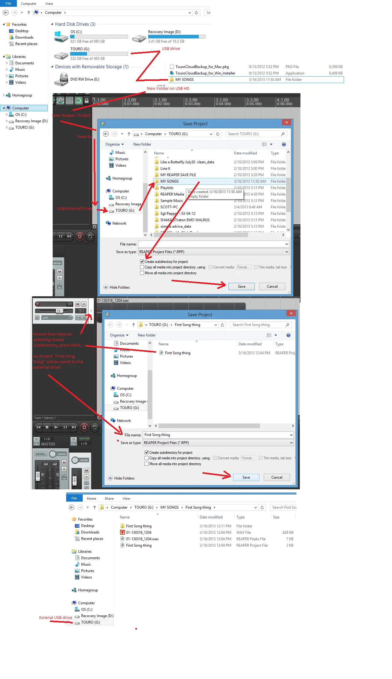

There are a number of things you need to think about
1 You are right about your limited storage, but it need not be a handicap. You've got an external hard-drive, so use it. Forget about the 2Gb.
2 Reaper is very good at not losing stuff. That's a blessing and a bane. It means that unless you explicitly delete files, they will just hang around. This includes all the crappy takes and false starts etc during a recording session. Deleting them from the Reaper screen doesn't delete them from the drive, so you can accumulate unwanted files very quickly. Reaper has a file option called 'clean up directory' or something like that, and that's a handy way of getting rid of unwanted files and freeing up space. But it is risky . . . see the next point.
3 It is wise to develop a way of managing your songs. There are many ways of doing this, but one way is as follows:
* first of all, go to your external drive and create a folder called 'my songs' are similar.
* when you want to record, and before you do, load up Reaper, then go to 'save project as' and save the project with the song name into the folder called 'my songs'. Check the box that says 'create sub-directory'. The files for that song and the Reaper Project file will all then be saved in a new folder within 'my songs'. If you have a need to move that song around, you can just grab the whole folder. Or you can delete the whole folder, knowing that you are only deleting the files for that song.
* when you've finished work on that song, you can go to to File/Clean Current Project Directory, and Reaper will get rid of all the stuff not actually used in the song.
* If you get excited and forget to create a directory for a song and just start recording, Reaper will save the files to a default folder (something like Reaper media or similar). That's okay. Just go "Save Project as', specify the location, and check the box that says 'move all media into project directory'. Doing this prevents (a) files being scattered across various folders, and (b) different song files ending up in the same folder.
That's really helpful!
I did a sloppy paint as I tried this method, worked really well and easy.... very nice.

I wanted to take time-out to thank you for this very wise and informative post on file management with Reaper. I have the Kenny Gioia "Reaper 4 Explained" DVD from groove3.com and albeit still learning, but this post of yours is reason I have read many hours/days of posts here doing proper searches without to date posting a question; a big kudos out to you!
