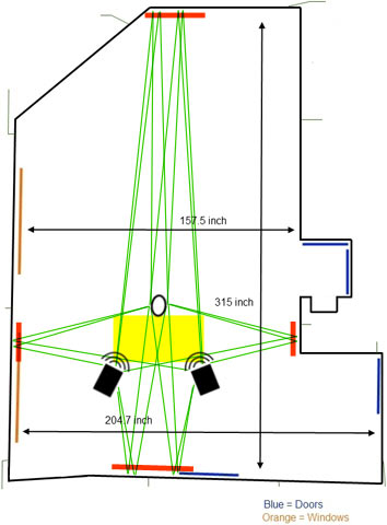

Yet more helpful advice. Most simple room treatments will start with bass traps in the 4 vertical corners of the room and broadband traps on the walls and ceiling at what are called the first reflection points - in the picture below the red (walls) and yellow (ceiling) traps are placed to absorb the sound (green lines) that would reflect straight off a boundary straight to the listener.
Great Diagram Cap! Is that your studio floor plan?
No, it's not mine. I was helping someone yesterday over on Gearslutz and remembered drawing the traps and green lines to show the first reflection points onto the room owner's picture. Mine is a mess at the moment; I am still building traps. This is mine:
