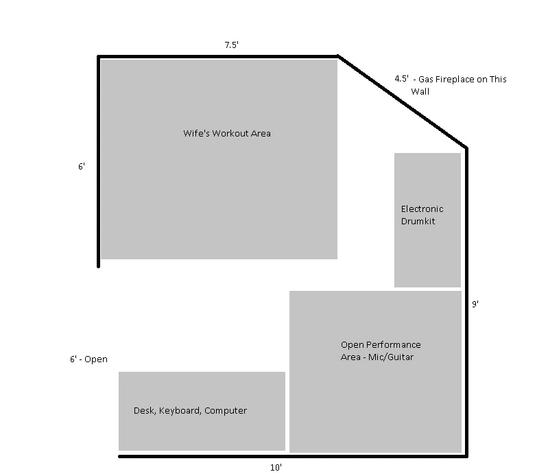

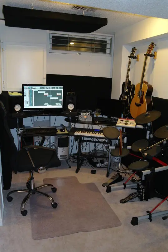

Hi All,
My wife has approved moving my studio from my little 6x6 cubby in the basement to the larger room which is approximately 10x12. I'm super excited about this but could really use some help on treatment. I've attached a room layout with footages, a pic of the new space and a pic of the old space with all the gear so you can have an idea of what needs to be moved into the new space along with the current home made absorbers that I have. Any help would be wonderful and appreciated.
Thanks,

I don't feel like I have golden ears which is why I'm hoping for suggestions based on the information above. I have a ton of home made absorbers that I can use. Some are built 2" OC 703 and others are 4" for bass absorption. Just wondering with the shape of my room where the best locations are to use them.

Something is odd about your plan. It looks 180 degrees reversed from the picture. I'm trying to get a grasp on the perimeter layout of your space, but something is not right. In the plan, the drums are on the left side of the corner, but in the pic, they are on the right side. Same with your recording setup. It's on the right side of the corner in plan, but on the left side in the pic. And what does that "open" mean? Open to what...a patio? a ballpark? a kitchen? The reason I ask is because of the "coupled space" concept. Delayed reflections from an adjacent room through an opening will alter your perception of what you hear in the monitors.
Thanks Rami
Chronicle. The first pic is the new space taken from the open area. The second pic is my current space just to show size of gear, panels, etc. The new room is actually open to my current space...beyond that is the doorway to the stairwell. Hope this makes sense.
