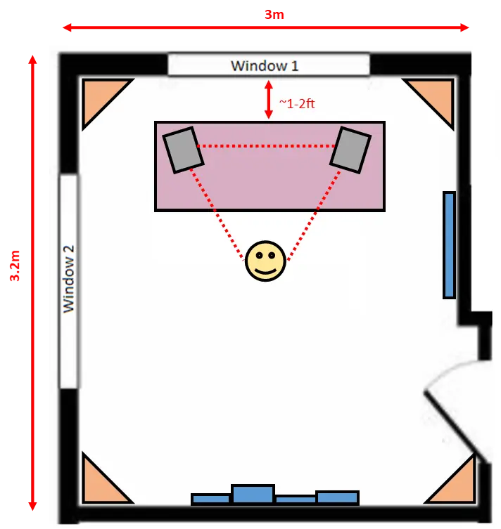

I've recently moved into a new property and I'm setting up a studio in the spare room.
Only problem is that if I place my desk so that the speakers project along the length of the longest wall this means that I have Window 1 behind the speakers and Window 2 at the first reflection on the left (from listeners perspective).
To compensate for Window 1 behind the speakers I can pull the desk away around 1~2 ft to minimize reflections however I'm not sure what to do about the reflections from Window 2 - If this was a solid wall Id usually use an absorption panel to treat first reflections. I was wondering if using heavy or sound insulating curtains in front of the window would work similarly to an absorption panel?
I've attached my basic attempt at a treatment layout and would be interested in any advice / comments to improve (I've omitted ceiling treatment i.e clouds and corner bass traps from the layout to keep things simple but they will be used)
Cheers!
Andy
