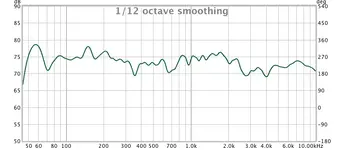

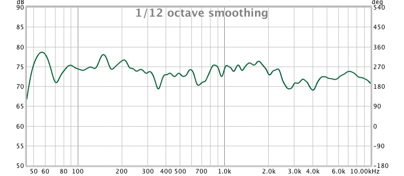

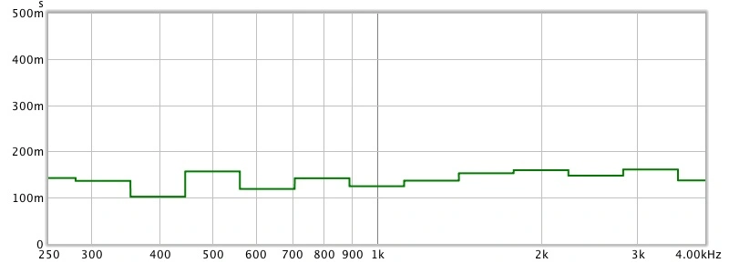

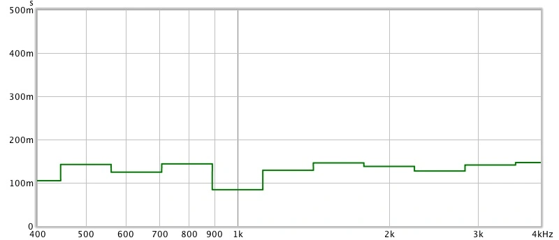

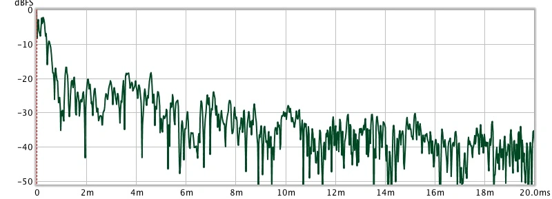

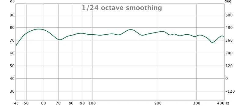

I've been reworking my recording room and I'm stuffed. I'm not sure if I could build another bass trap or measure my room one more time. I've managed to control the low end (45hz-400hz) to within an 8db range and my frequency response looks reasonably flat at 1/24 or 1/48 smoothing. My waterfall indicates only limited ringing at or under 55hz, and much of that can probably be attributed to the noise floor. And the impulse response seems okay--At least judging from standards that I can discern online.
Of course, the room is dead as a doornail (see Topt) and I know this irritates some folks. Personally, I like things a little comatose, and this may be largely unavoidable in a small room setting. I may start adding slats or perhaps exploring diffusion, but I think I need a break. Besides, I think I need to record something before I become a complete engineering geek.
So...what say you? Should I push on in the hope of achieving +/-6b? Is there such a thing as too much bass trapping? Will I die from 703-related cancer? Should I start a Go Fund Me page to raise money to buy a half dozen GIK Scopus T40 tuned traps to attack the low end ringing which is probably noise? And what about the other end of the spectrum? Should I even care?

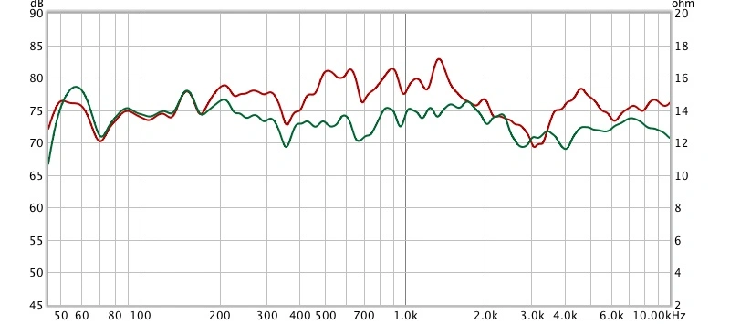

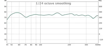

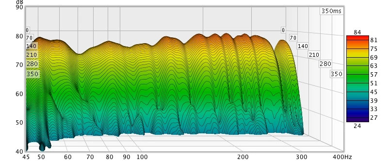

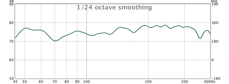

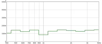

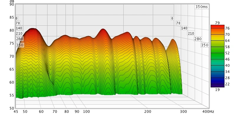

Not surprisingly, the new results are not too far off the originals posted above--at least for the low end under 250 hz or so. And that's a good thing. Part of me was fearing the new test, thinking that I just spent too much money on new monitors only to get a worse result. Of course, I'll probably repeat the test after the speakers are burned in. Again, I don't really expect too much difference. But a variable is a variable. :D

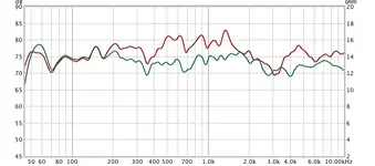

Some things in the high end, however, did change. It turns out that the new Adam A7x's seem to perform better above 400hz than the old Event PS6's. They are flatter and a lot less "hyped" in the range from roughly 400hz to 2k. (see plot below. RED=EVENT. GREEN=ADAM). The Adam monitors also seem to do a better job sorting out the crossover point to the tweeter. Both monitors list crossover points at about 2.5 to 2.6k. But, at this particular frequency, the Events seem to take a dive followed by a serious peek in-between 4 and 6k. All in all, this transition is much smoother in the Adams.
Of course, the Adam speakers cost $1,500 bucks. For that much, they need to be flat and fetch my morning coffee. :D And it may be that some of this is just window dressing. Many people argue that the human ear/brain does most of the heavy lifting in the upper mid and high frequencies. Psychoacoustics solves many issues and the may be one of them. Still, I like to see flat. I paid for flat and I want flat.
  • 45-10k 1:12jpg.webp
    45-10k 1:12jpg.webp
