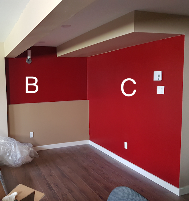

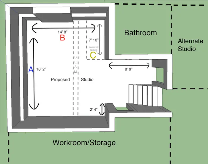

The larger of the two rooms, the dimensions of which are shown on the attached plan and is designated "Proposed Studio". The ceiling height is 7' 4". There is a steel beam running across the ceiling. The beam is covered in drywall and extends from one end of the room to the other, and a small part of the ceiling has been lowered, all as you can see in the attached photo. There are two windows along wall "A". There is a 4 inch ledge from the floor to about 1/2 way up the wall, running the length of walls "A" & "B". A portion of wall "B" has been built out to conceal an old brick chimney, no longer in use. There is an open ceiling directly above the staircase that leads upstairs. I've tried to show all of these details in the attached plan/screenshot.
The smaller room or "Alternate Studio" is rectangular and measures 10' 2" x 12' with a ceiling height of 7' 4". There are no windows, just a door as seen in the attached plan.

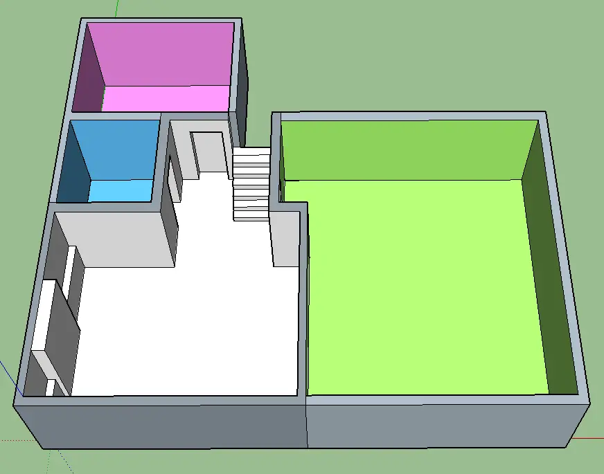

I would have also included a rough SketchUp file showing the entire basement had the forum rules permitted. Instead I've attached a screenshot of the SketchUp layout.
The white room is the "Proposed Studio"
The blue room is the bathroom
The pink room is the "Alternate Studio"
The green room is the "Workroom/Storage"
Which of the two rooms would make a better control room? Are the beam, lowered ceiling and/or irregular shape of the "Proposed Studio" problematic? I'm also concerned with the small size of the "Alternate Studio". Is the room too small to use for a control room focused on mixing bass heavy music?
If my best choice is the "Proposed Studio", which wall should I be facing when I'm sitting at my desk? Should I be facing wall "A", "B" or the wall opposite "B"? If I'm facing the wall opposite "B" will there be enough room to place absorbers at first reflection points?

Without any hesitation...the larger room. :)
Put your mix position either at the A, window side...or at either of the B sides.
I think they all are good, though one might be a bit better sound-wise, and also aesthetic-wise...your call.
The cool thing about using the A side is you would be firing the speaker back toward the stairs...so that extends the distance and that area at the stairs can be used for natural trapping....but you will also need to add a good deal of treatment in the room.
That said...the work/storage space is probably the best...but I say that without knowing how it's currently finished and whatever issues it may have.
I assume it's not a consideration since you didn't even mention it as a possibility...?
