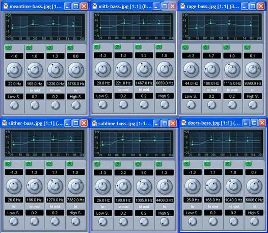

About the bass: I gave the mp3 to several ppl for review, and got a lot of 'no bass' comments, so I pushed up the bass fader more than I thought I should have. I only notice it in my car really, it's definately bassier than commercial music. Sounds ok on my monitors, not offensive at least...
Bass eq curves are shown below. The bass eq curves are very slight cuz it was recorded DI from a POD, which is supposed to be more/less ready to record. I thought bass would be the easiest thing to get set, it's ending up giving me the most trouble! I'm interested in seeing other ppl's eq curves for bass (and other various instruments), similar to the pic below, esp. if there's an mp3 of the final mix with that curve. Does such a thing exist? I think it could be real helpful
