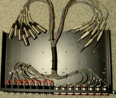

Another thumbs up here for redco.com . I built a patchbay a few weeks ago. The shipping was lightning fast (I'm talking next day) and they did ship me rca's instead of 1/4" jacks like I ordered. I emailed them at 4pm and the 1/4" jacks were at my door the next morning. Great customer service, along with the prices.
