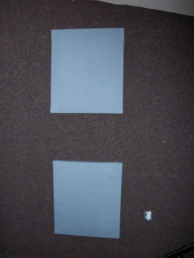

Another thing I might add about the fiber retention of the fabric, is make sure you get some good fabric to cover your panels and traps with. You would be surprised how those little fibers freely come off the insulation with NO air circulation in the room. As I was installing them, I could see them in my overhead lighting- it looked like a dusty old barn with the sunlight shining through the windows... Make sure they are covered well.
