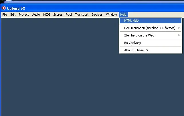

Cubase has a manual built into it. Here is where it is -
