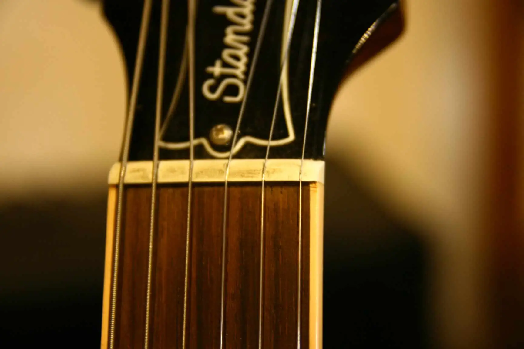

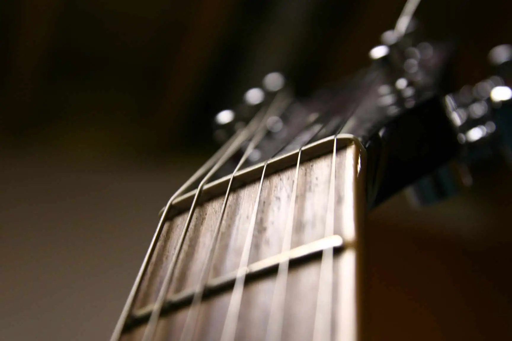

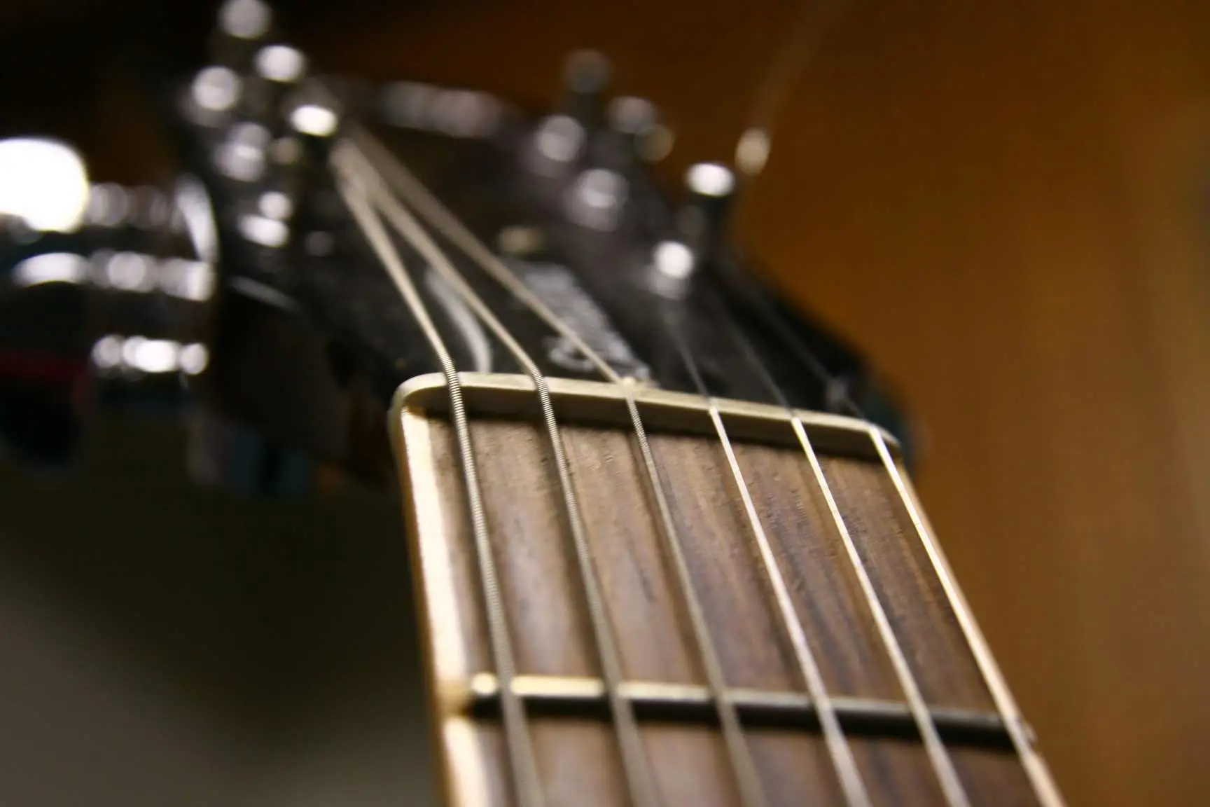

I tried the exercise from post #48 to check for nut squeeze. I constantly have to tune the G string even after stretching the hell out of it. I tuned it up, bent it as far as I could and it went about 20 cents flat. I then pushed on the string between the nut and tuner and it went about 20 cents sharp. Sounds like nut squeeze, correct? I've attached some photos of the nut on my Gibson Les Paul Standard. It doesn't look right to me even after taking it to a repairman. Next thing I am going to do is try the string locking technique from the link in this post when restringing.
thanks,
Mike
thanks,
Mike
No. Tying a knot at the peg or doing an over-under wrap won't help you; it's friction in the nut slot that's retaining the tension, and there's nothing you can do at the peg to counteract it.
BTW, I did that knot thing exactly once. It didn't solve any tuning problems and it was a b!+(# to get the high E string loose from the peg when it came time to change it.
