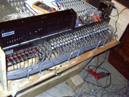

I've wired MANY of those bad boys. Are you wire wrapping or doing a punch block for the rear connections?
Anyways, this is the second installment. This may be too much information but here goes. This is an individual jack frame out of the patch bay in a soldering vice soldered up to a cable. When I get all the frames for one bay soldered, then I reassemble them.
With the intention of punishing myself, I will be soldering. Endlessly!

Oh yes. Them ugly wires will be completely boxed in when it's done. The carcass I built to hold the mixer, patchbays and BRC forms a bridge to set the nearfields on. That'll be the last thing I assemble so I can get to all the plumbing if I find a problem on the shakedown cruse.:D

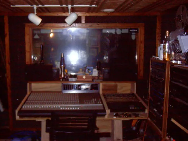

The console

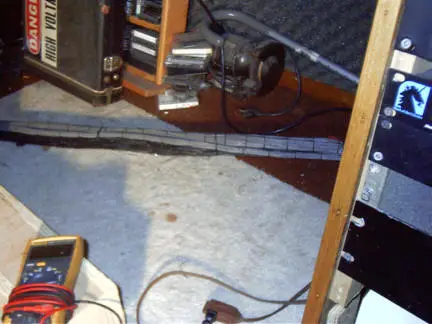

Not very exotic Michael. The snake just runs from the console on the floor to the racks but it's not in plane sight so it's OK with me.
