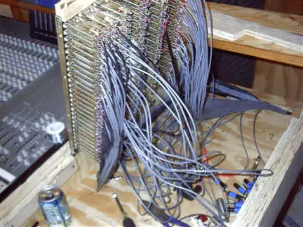

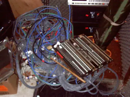

The old wiring harness that I worked my ASS off on.

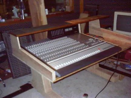

This is the new mixer setting in the desk I'm still fabricating for it.

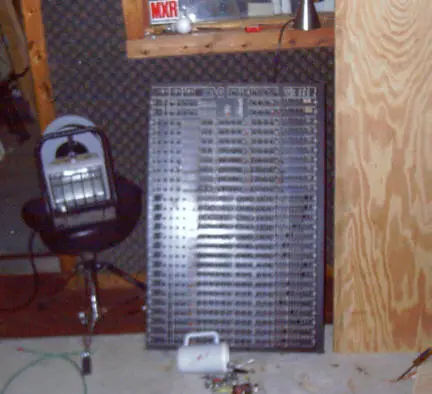

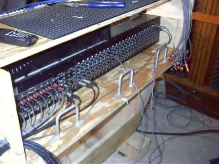

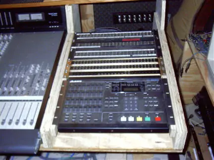

I set the patch bays and the BRC in last night. I anticipate that the work is going to take at least another three weeks to complete. If anyone gives a shit, I'll update as I get things finished.

That desk looks really sharp. Can't wait to see how it all comes together.
Darryl.....

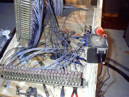

Anyways, this is the second installment. This may be too much information but here goes. This is an individual jack frame out of the patch bay in a soldering vice soldered up to a cable. When I get all the frames for one bay soldered, then I reassemble them.

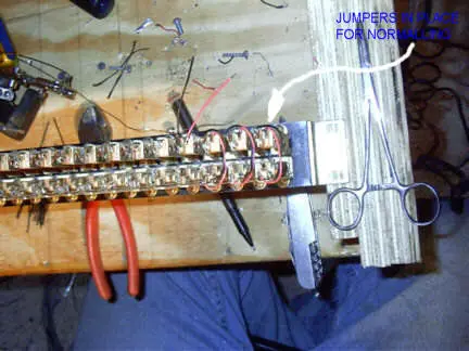

The only exception to building the bays this way is when I build normalled connetions for the inserts and such. Then I remove the bay from the rack and first solder the normalling connections. Unlike a lot of patchbays on the market where you just flip a PC board to nomal/un-normal, these Switchcraft bays have to have a few jumpers soldered in place.

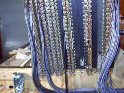

Then comb it out and tie it down with 9 ply wax rope.

I just mounted the bridal rings on the back to tie to and now I'll begine the business end.

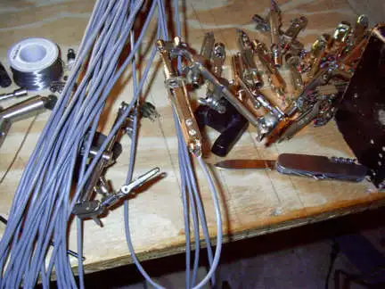

One of my most important tools.:cool:
