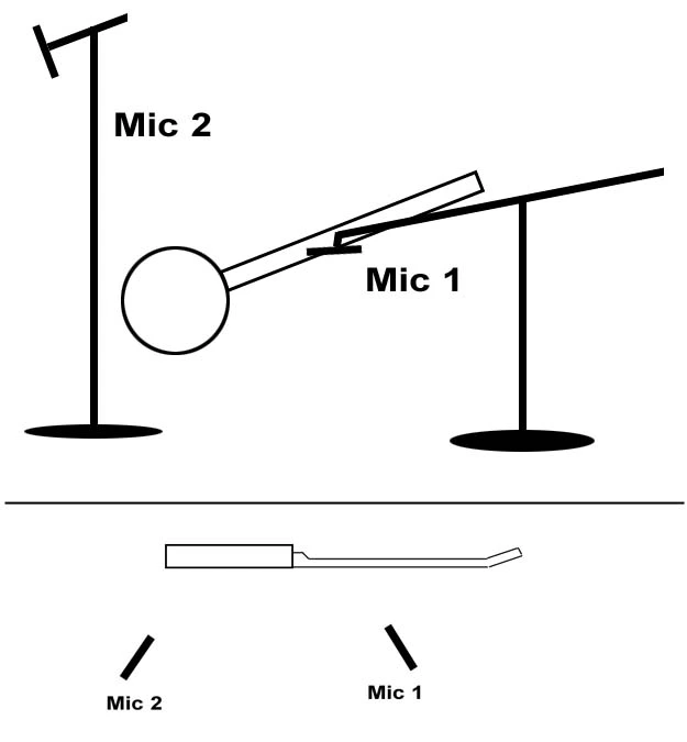

I record a lot of bluegrass and am quite happy with this scenario.
2 SDCs, usually at 4041's but on occassion SM81's.
One in the front. Slightly higher than the fretboard, about 14" out and angled back toward 12th. fret.
The other coming over the player's shoulder about head high. Slightly out in front of the instrument and angled down toward the bridge area.
Season to taste.
Of course,the banjo has so many variables, it really helps if the player understands proper set-up and technique. More so than an acoustic guitar player. Just my 2¢...
I'd be happy to post an example but it will have to be tomorrow when I'm at the studio.
