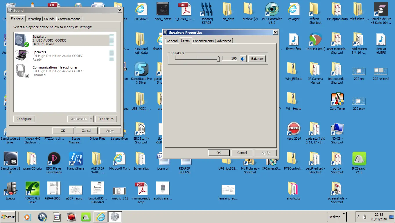

I strongly suspect that there are no ASIO drivers and the recording gain has shot back to 100% under the dead hand of a Windows update or glitch. Gimme a minute and I shall find a screen grab...
Attached. If I am right that record level needs to be about Five %.
OOOPS! Yes that IS the play level. Same idea, just hit the Record tit.

Thanks for all the help guys. I've kind of fixed the problem by lowering the volume of the microphone in the windows sound settings, not sure what it was at when it was all fine before, but I can make it no longer clipping and abrasive. No idea why this happened though, I've never had to touch these settings before. It was all fine when I first started using this interface, not sure what could have happened. Any thoughts? Thanks again for all the help, everyone.
Windows 10 update would be my suspicion, if that's the OS you're using.
