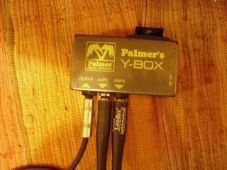

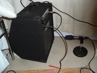

Jason, I've just done a bass session where I put some bass on a couple of songs. I used my 3 track method ~ miking the amp, running a line out and going directly into my DAW. I have a Y box which enables me to connect the bass to two amps or two of whatever. resize ybox.webpWhat I did was to {via the Y box} connect the bass to my amp (output being the line out) and use the other output to go directly into my DAW. Then I miked the amp too resize amp.webpso I got three very different bass sounds. The way I set the knobs on the amp was to cut off most of the bass (-4) and up the treble (+1) and the middle right up so the sound of the bass out of the amp is quite trebly ~ but the line out sound and the DI are not.
Eventually, I'll combine the three sounds into one {I like to commit early on in the process} but this gives me some scope. I don't want to blitz your head with excess but it's one way of a few that you can consider.
