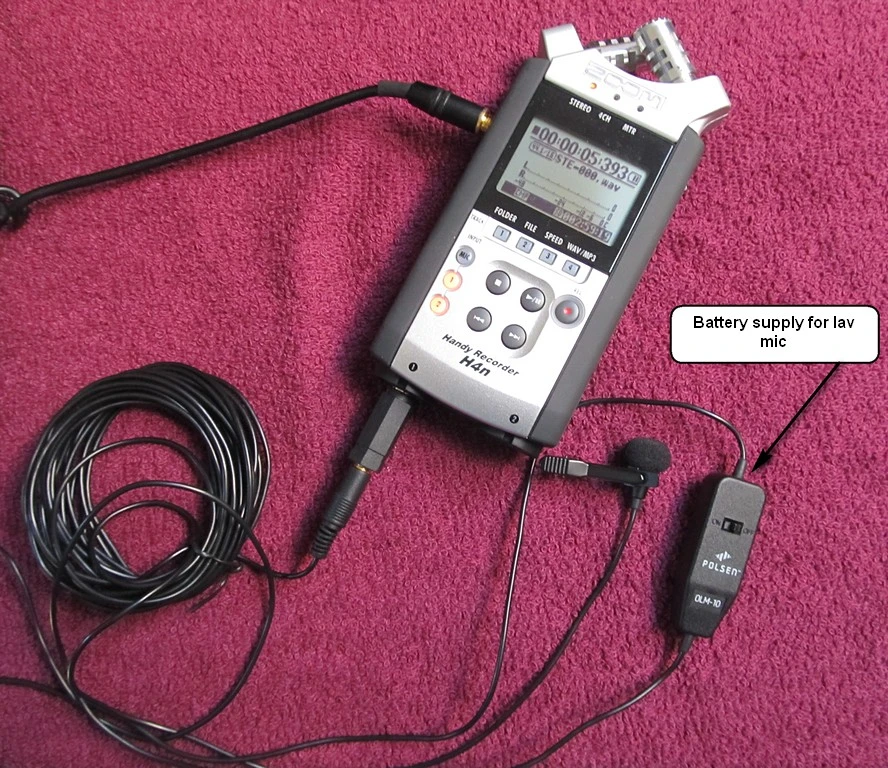

The mics on the headsets likely need 'plugin power' which they would normally get from a PC's mic jack (I assuming the mic plug is a TRS plug(tip-ring-sleeve). You would need an inline battery power supply like shown below and an adapter to be able to plug into the 1/4" part of the combo jack on the recorder. Do not try to use phantom power (XLR jacks) from the recorder if it has it.

Yeah, if the 1/4" inputs have enough gain that would be simpler than using transformers to XLR. I'm glad someone's already built a standalone plug-in power supply. Saves me the trouble of doing it badly.
