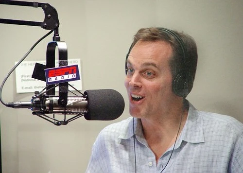

Nice mic, very common in the broadcast (radio) realm, particularly in the USA. It's also better at isolation than a condenser mic with a similar pick up pattern.
However, don't forget that in the broadcast world, they don't just rely on the mic and put the announcer in the middle of a noisy office. The studios are acoustically treated and, in all but the most basic community station, have some form of sound proofing.
