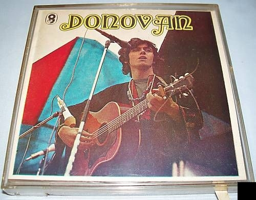

PIC of my record Club MONO tape. Came Royal Air within a week. What am I gonna play this on ? Does alright on the Wollensak and others, but those telefunken tubes take it up a notch
