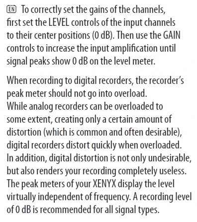

- If you plug headphones into the mixer do you hear the hiss or is it only when recorded?
- How are you setting the gain and levels?
