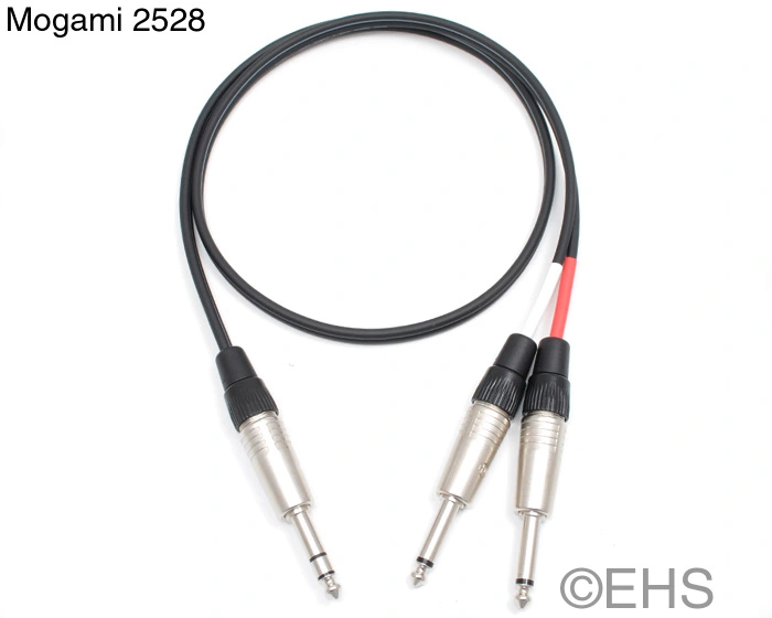

The R24 has in the onboard firmware, compressors which I prefer for my recordings but it's them that I am not happy with regarding the vocal quality so I intend to buy a DBX 286s pre-amp channel strip just for primary vocals. The DBX 286s is a pretty simple but very effective device for the job which presumably I should be able to link and insert directly into the R24 and use the 286s between the R24 and mike or instrument. On the rear of the 286s there is a TRS/XLR input for microphone/instrument. Also a TRS line out and a single TRS insert!
Now it's regarding this insert that is the question!
On the top of the Vizualizer there are diagrams of the unit's TRS wiring and it looks as though with the correct lead, I should be able to feed the output effects of the vizualizer into the channel strip so that I can add them while recording mic or guitar.
The Vizualizer's back panel ...2 channels of both TRS and XLR inputs and outputs.
The question is, can anyone confirm as to whether or not the effects of the Vizualizer can be added to to the output of the DBX 286s ( via the 'insert' and suitable lead) before it is recorded by the R24?
