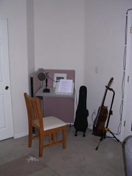

I'm uploading a photo of my recording area.
I'm going to put some cloth on wood frames and hang them on the wall like pictures. I was wondering if that is a good idea, or if it will cause problems?
I rent, so I can't make any permanent modifications. Any acoustical advice will be appreciate it.

fabric over a wood frame by itself won't do much. Stuff 709 rigid fiberglass or rockwool in the frame behind the cloth, and you've made yourself a decent bass trap if its large, or a nice midrange trap if its small.
What acoustical problems are you experiencing?

Well I haven't done extensive testing, but I have a low voice, and when I record I get a sound that I can only describe as wave build up.
I know, I don't know the terminology. Basically, after perhaps 20 to 30 seconds of me speaking (perhaps more like 5 to ten) I get this strange low noise wave. I figured since its a boxy area that my voice was bouncing back and forth and creating a strange acoustical effect.
I've moved the microphone from that area to do other setup tests. I've been trying to figure out software, configurations on the mixer, my Delta 44 soundcard as well as other issues. So I got tired of walking back and forth between the computer and the microphone, and it was kinda hard to see what was going on or change the settings on the mixer, I moved the mic next to the computer.
I just moved the mic back and have not done any testing since. However, the small amount of testing I've done gave me that. Hold on, let me test and see if I have any issues now.

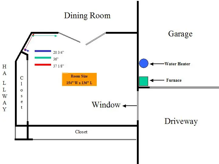

Oh! here is a quick diagram that I drew. Just in case it helps!
