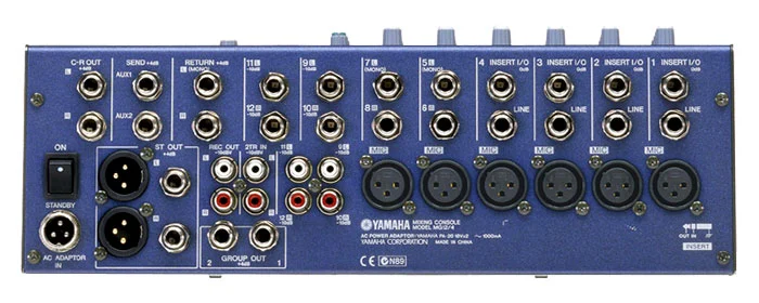

Does that Yamaha mixer have enough output busses for 6 channels to be handled independently? I can't tell from the specs, because I don't know that much about mixers. Here is a pic of the back of the thing.

guttapercha said:
Does that Yamaha mixer have enough output busses for 6 channels to be handled independently? I can't tell from the specs, because I'm don't know that much about mixers. Here is a pic of the back of the thing.
The inserts can be used as direct outs by inserting a 1/4" jack plug half way in (until you hear the first click).
useful addition
Looks like only 4 channels have inserts on this mixer. I suppose the other two channels could then go through the master for the total of 6 that you speak of.
Yes, it's a cheaper solution than the Firepod. But you might want to bring that total $ up a bit more for the additional cables that this way will require.
A cool way to do it might be to wire custom TRS cables where the ring on one side goes to the tip of the other, so you don't have to do the half way in business.
The firepod might still have added value for this person though b/c of the MIDI interface (he's got a synth). There are lots o' VST instruments out there (free ones) that give worlds of options.
